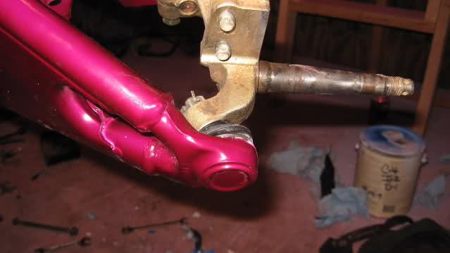

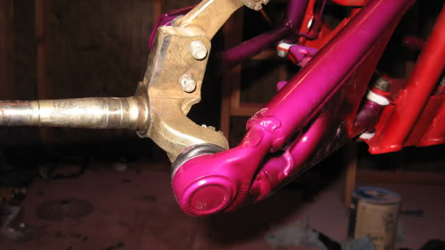

Iam putting my blaster back together after repainting,and seems i need some help
Need a picture of where the tire rods bolt onto the spindles,on those two bolts,are there nuts on the bottom? or just a cotter pin?
Do you mean the two bolts on the bracket for the tie rod? I'm not positive without seeing it but i am pretty sure there are no nuts on those bolts. The tie rod goes with the end at the steering stem up through the hole and the other end at the spindle down through the hole. Both then have the nut and cotter pin. Hope this helps, i can try to find a picture if you still need one.
The two bolts on the mount between the spindle and tire rod..do they suppose to have nuts on them?
Nope...they thread into the spindle and just have the cotter pin underneath. Paint looks good btw.
Thanks i started today putting it all back together and stopped there cause i couldnt find any nuts in my pile that would go there,though i lost them,but yea they do thread in and have a hole for cotter..
