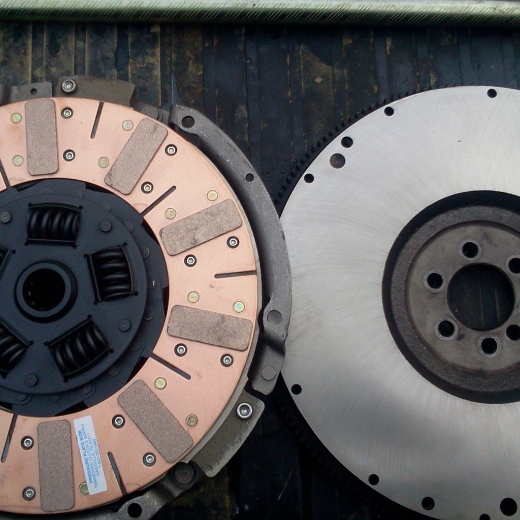

i went andgot a new clutch for my truck because when we pulled the pressure plate off it was worn so i picked this up today
