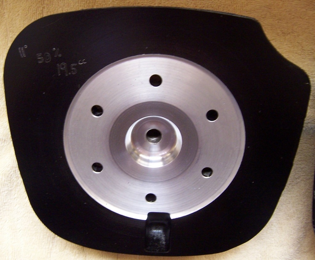

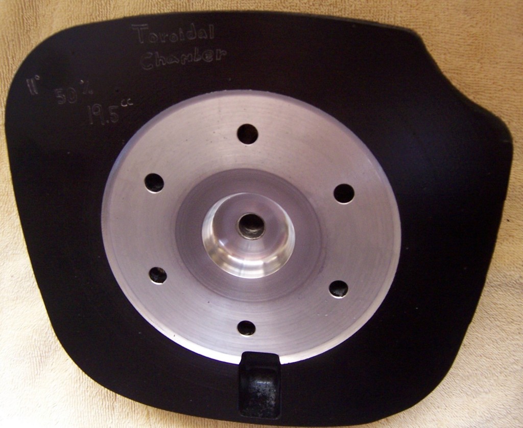

Here's a 19.5 CC "toroidal" I did for Steve (Best). You can see the depth of the cut that I had to take to get that size of chamber It was quite a bit...

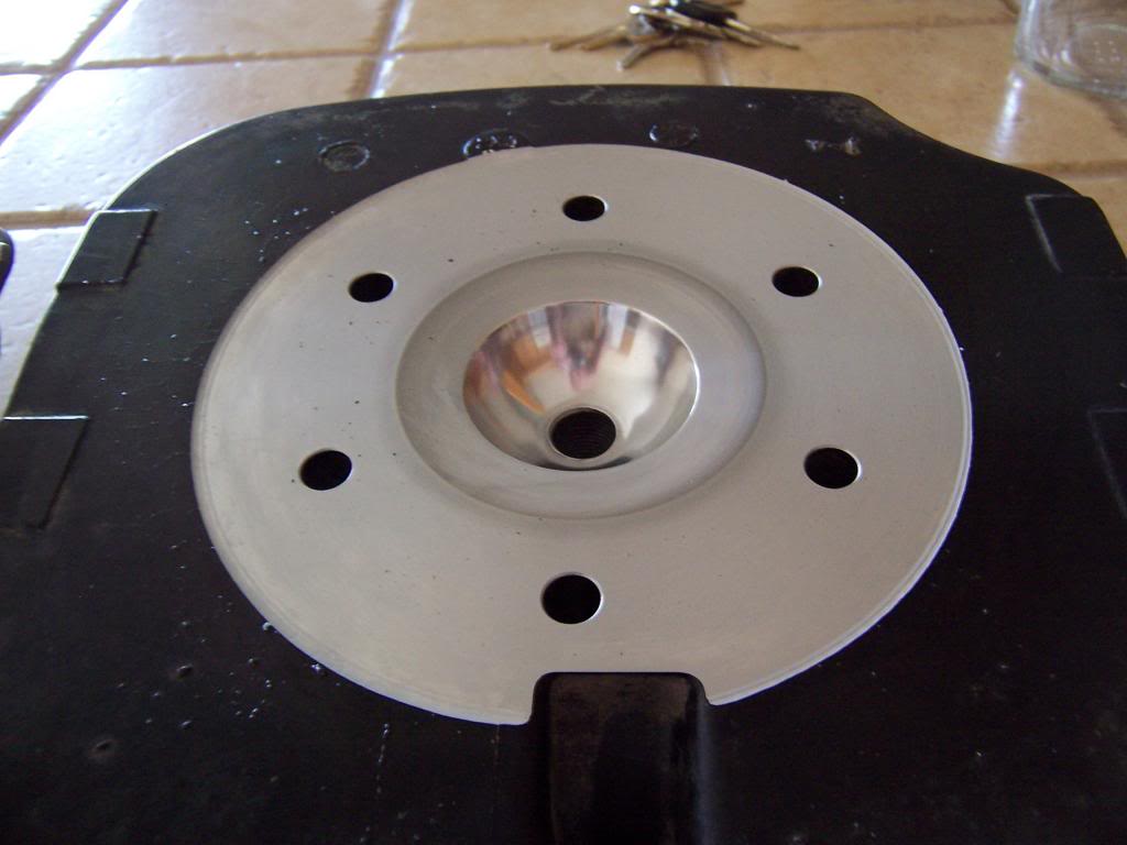

Here is the Wwholden head. See how deep the chamber is? This is why I would CC it to verify its size...

ok guys, I cc'd the head today and if I did it right I came out with 30cc's. That's a far cry from the 20 I was promised. I read sicivicdude's article on head design and I understand it. With wwholden's design he didn't put a ramp in for the flame to change direction from linear to vertical travel in the chamber. It does a 90 degree angle from the roof of the chamber to the side. This bothers me and makes me think it would disrupt the flame travel. As I said before it measures 30 cc's. Could I and would it be worth my time to add material to the chamber to change it to a 45 angle instead of a 90. I could tig weld itit would also reduce the side of the chamber. Im just not sure how much weld to put in.
30 CC's???! I knew it was more than 20 CC's just looking at the picture. I said it looked to be 27 CC's or more. WOW! It was more than I thought.
