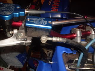

Need to know the specs from my front brake lines (banshee 1989 fited on my blaster) to order new ones. (YAMAHA XV1700 WARRIOR FRONT RACE BRAKE LINE KIT 04-05 on eBay (end time 09-Feb-10 09:26:00 GMT))
But i have absolutly no clue :-/ how classifie banjos..... Can anyone give me a help ?

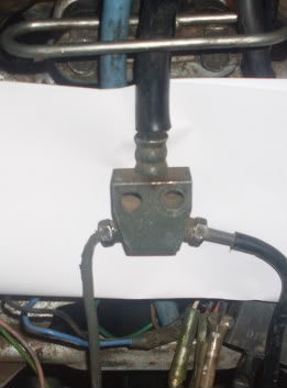

How about this spliter. Y spliter ? T fitting ?

the splitters dont come apart from the line, it's crimped into the block, heres what im gonna get .......

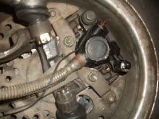

but youll have to ask them if they have them for the older style calipers, your pre 1990 calipers dont have a banjo fitting, i think thats called an "an" fitting????
