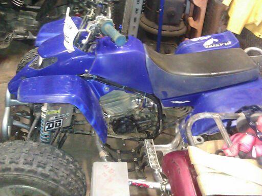

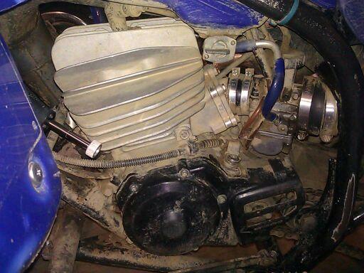

whats it got for a motor??
How do I change it back to where it is stiff both ways turning right and left when I turn right it is stiff when I turn left it is nothing
Power plant
KOR ported ct250 big bore trx250r intakeBoyessen rad valve
Keihn 35mm pwk carb
Cam airbox
Power pros exhaust
Reed spacer
Amr monster coil
Lightened flywheel
The blasty chassis:
Burgard +2 up 1 extended a-arms
Works front dual rate shocks
Hydro front brakes
Aluminum front wheels
Itp holeshot front tires
Dg bumper
04 hood
04 headlight
Alba steering stabilizer
Banshee stem
Banshee petcock
Clarke 3.5 gallon tank
Clarke gas cap with anodized tip
Pro design racing tether
Bar risers
Nacs racing handelbars mount
Ours grips
Dg hydro cover
Sunline clutch lever and perch
Tusk d flex handguards
Cfm airbox
Xfr nerf bars
Works performance rear shocks with rezzie
Extended swingarm
Rear grab bar
Durable axle
Maxxis razr rear tires
Douglas aluminum rear rims
Awks gyxr rear brakes
And that's all I can remember at the moment
Power plant
KOR ported ct240 big bore trx250r intake
Boyessen rad valve
Keihn 35mm pwk carb
Cfm airbox
Power pros exhaust
Reed spacer
Amr monster coil
Lightened flywheel
The blasty chassis:
Hydro front brakes
Dg bumper
04 hood
04 headlight
Banshee stem
Banshee petcock
Bar risers
Ours grips
Dg hydro cover
Cfm airbox
Xfr nerf bars
Extended swingarm
Rear grab bar
Durable axle
