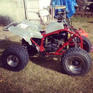

My little Project.
nicely cleaned up, that all black looked weird

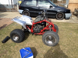

p.s. im liking that golf in the background of that picture :) my mom has one, but hers is a 07 gti Fahrenheit edition
Wasn't bashing, trying to help I:I maybe even a coat or two of spray or brush on paint to help beads seal
Didn't take it as bashing... thanx for the input .
Thanks.. Its a 95 GTI (not a golf lol) thats my other project
Looking good. Big improvement!
Thanks

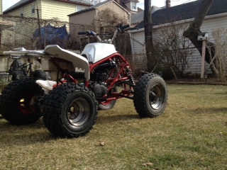

she is finally finished... didn't start tho, don't think I am getting spark, ordered a new ignition coil should be here b4 sat.. I will keep y'all posted.
Build looks great so far! Have a little rep for your hard work and determination to get it done. Also props for using a manual to figure out the ignition! I:I
If the $$ allows, Id get on ebay and pick up a good used 400ex or LTZ 400 rear shock. It will be a cheap and much-appreciated upgrade over that stock pogo stick rear shock.
Okay.. so I replaced the coil pack, source coil and still no spark.. took the cab off and cleaned it out going to install it back on in a few mins, new spark plug so lets see.. any suggestion ?
Finally got her running yesterday. Woodruff key was the culprit. So after letting her run and adjusted the idle and tighten up all loose ends. Decided to go up and down the block to test her. She ran decent then all of a sudden while shifting thru the gears I heard a grinding noise and she shut off. Took about 10 kicks to restart and started making the noise again. I shut her down. Now I have to pull the motor and check the transmission and motor internals FML

i'd pull the clutch and stator covers first to have a peek in there for the culprit of the noises.

Okay pulled bike apart. Found woodruff key broken in 1/2. Order 2 from Ken O'conner and got a harness from Awk.

the woodruff key broken was definately a huge problem, doubtful you need a harness, but it's on the way.

you should probably lap your flywheel to the crank, i think i saw some scarring in the pics you sent me, lap it until it feels smooth and flywheel gets hard to turn, indicating a nice tight, matching fit

Thanks Awk. It does have some scaring. Was wondering if I needed a new crank. Thank for the vid will do that this weekend.
