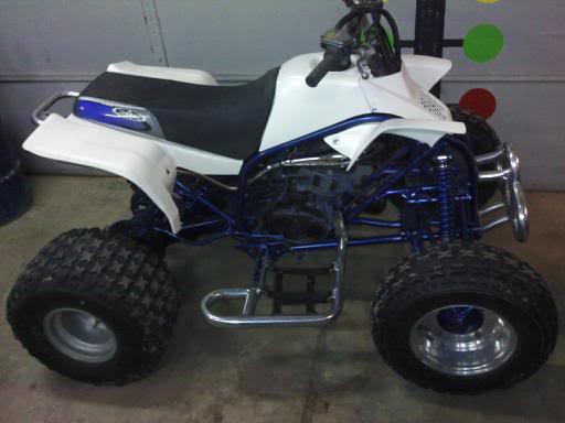

My ghetto 1 day revamp ( lots o pics )
oh wow so u just basically just sprayed it without taping much? at 1st i was thinking wow thats bad. but the end result came out not too bad! i like it. if only u taped up the motor
The motor looked like sh*t since day one. I'm going to polish it when I build it " right ". The main point to me doing this was basically to try out this color combination. I'm using this as a trial run before I spend the time to strip it down , and have things powercoated. I knew that if I stripped the quad down to do the frame I wouldn't put it back together till it's done right and I don't have the funds right now so I'd be stuck without a ride. At least this way I can see what it would look like and as a bonus my blaster looks a lot better then before. When it chips all I gotta do is hit it with a shot of touch up paint and I'll be good to go.

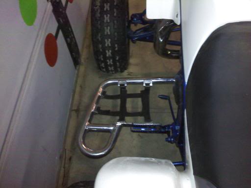

Oh yea, polished my nerfs and washed the webbing.
I'm happy to report that the blaster survived a 1/2 day of riding and a pressure washing without so much as a chip in the paint ( knock on wood ). While it didn't get caked with mud it did get enough on it that I had to take it to a car wash and use the pressure washer. I dont' have any vids of todays ride but here is where we rode , note the tall grass and I climbed the stone " hills " far too many times to count. All in all it was a great day , minus the fact that somewhere along the way I lost my phone > : 0 (
For $21 and a little time it looks great. Is it show quality? Of course not.

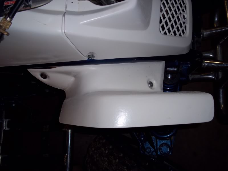

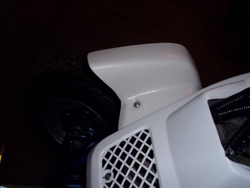

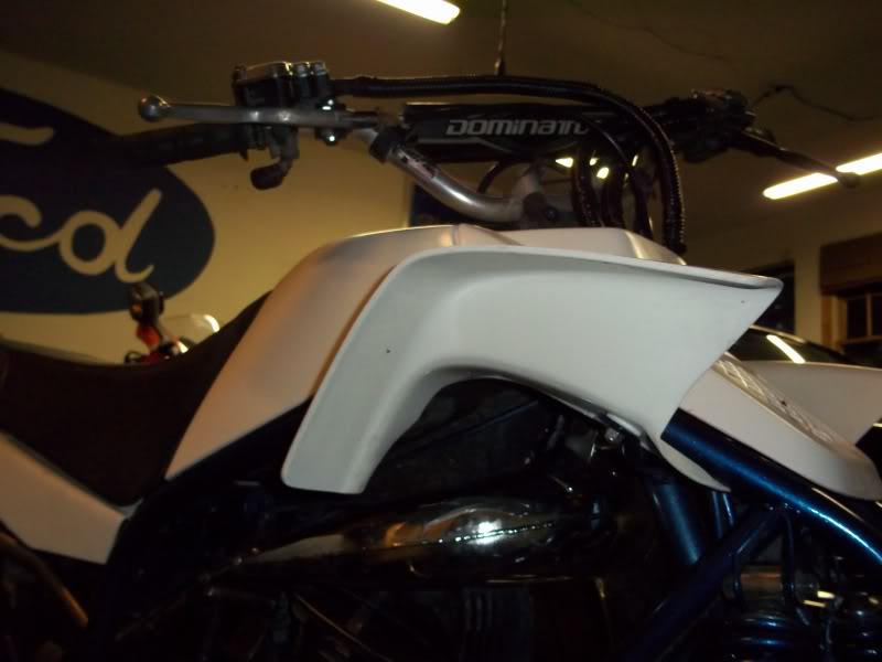

I think it looks great. I am sold on the frame color. Also like the way you cut the front fenders. Could you post some close ups of them?
I was skeptical about doin a "cheap" (my funds aren't in high supply either) paint over on my '94 but I wasn't sure how anything short of powder coating would look...but after seein how good urs came out I'm gonna ignore the few negative comments and give it a try myself as soon as I have some garage space....GREAT WORK
I'll try to snap a few shots of the fenders ( they were like that when I bought the blaster ).
