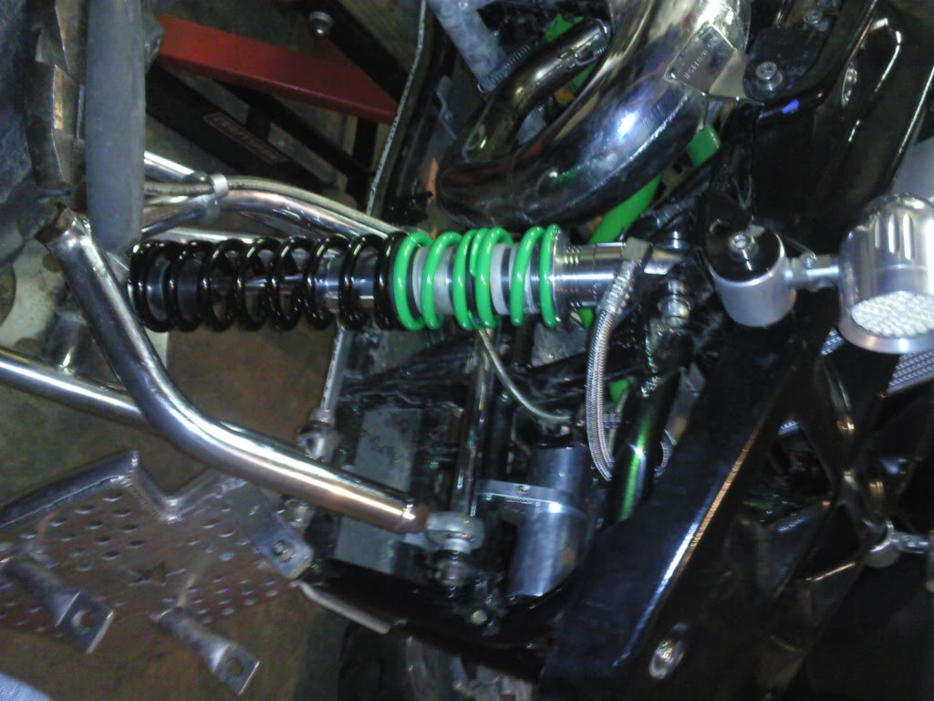

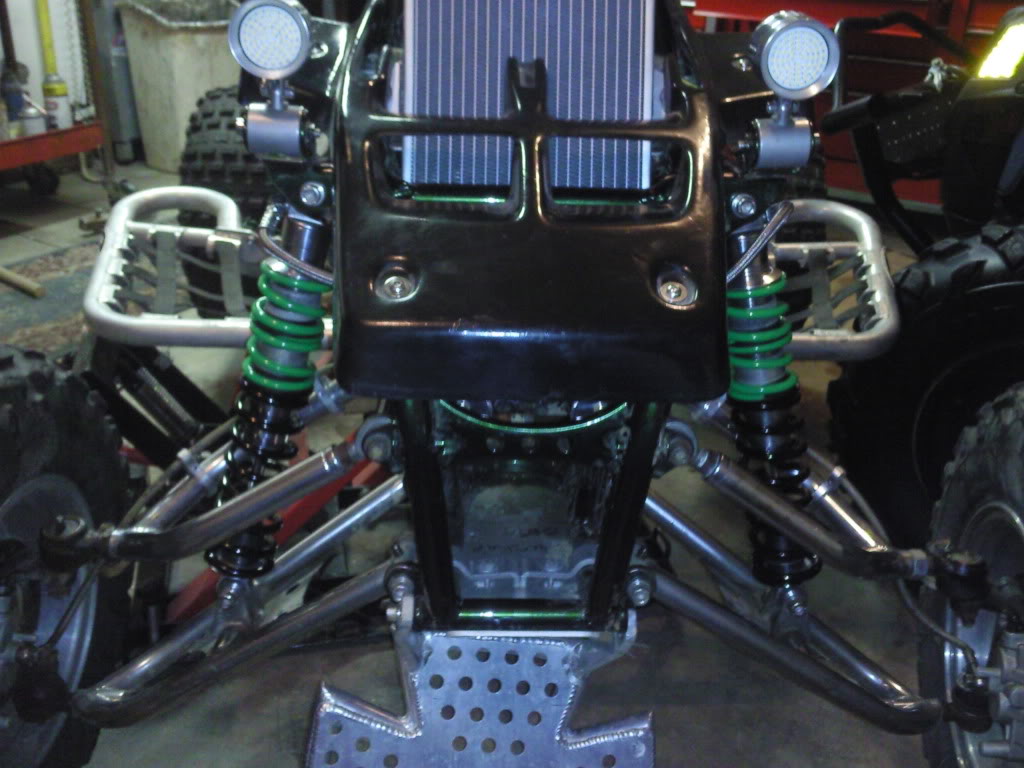

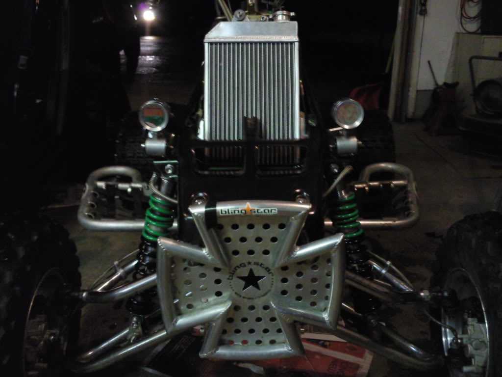

got the shocks installed

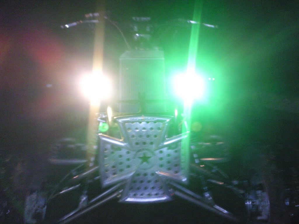

also going from warm white to green lights, might change again, have pure white and more green lights coming

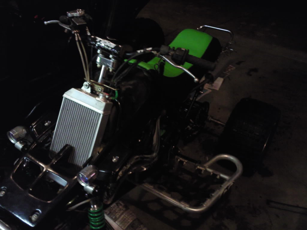

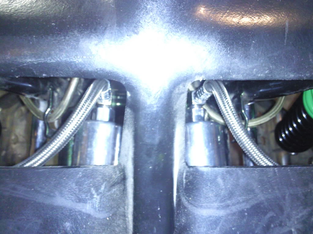

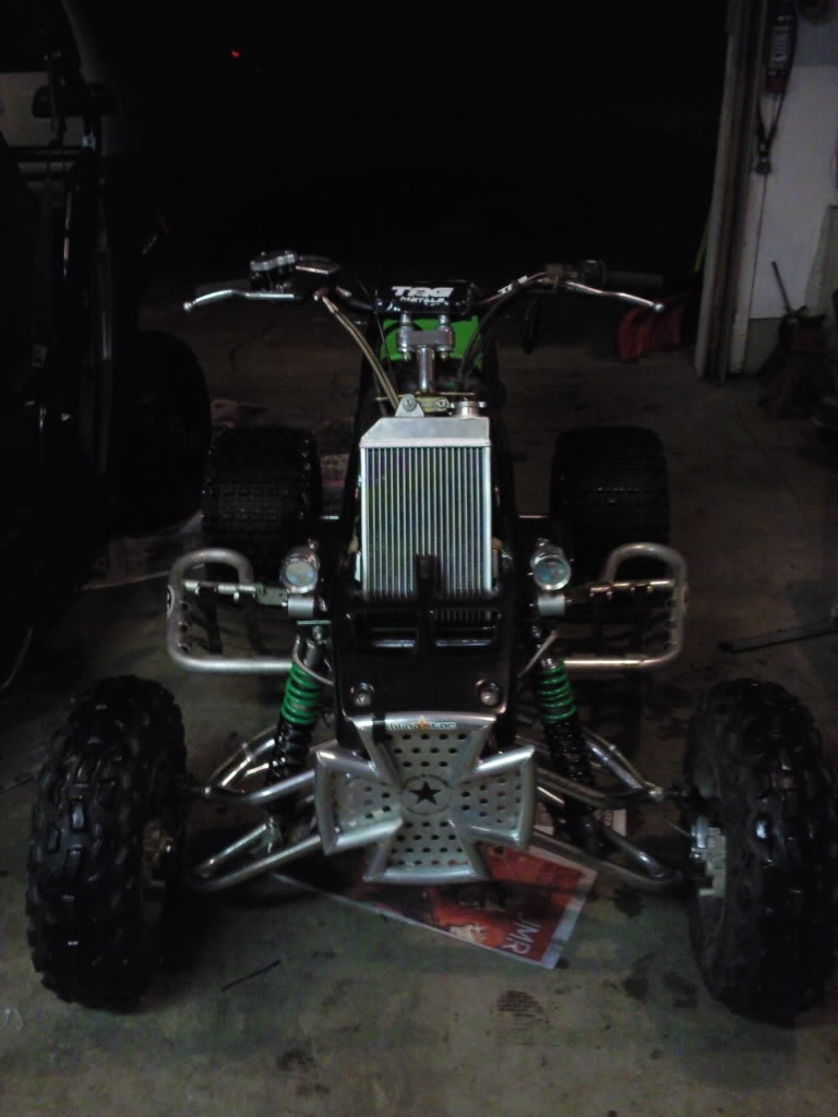

and just some pictures
Looking good! Like the shocks! Did you fabb the light mountings or did they came with the lights?
those are trail tech lights, they mount in the stock lighting position. those were $150. i could have gotten the HID trail tech lights, but at $350, they were not worth it.
