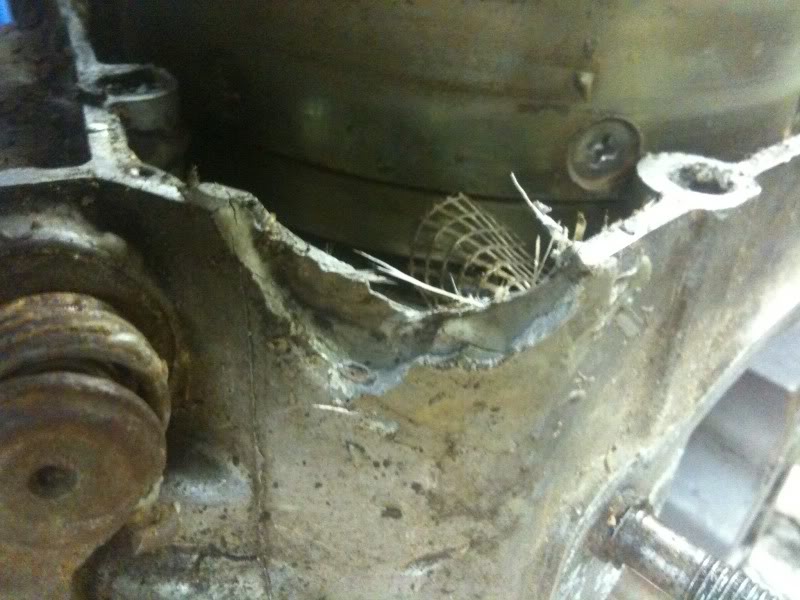

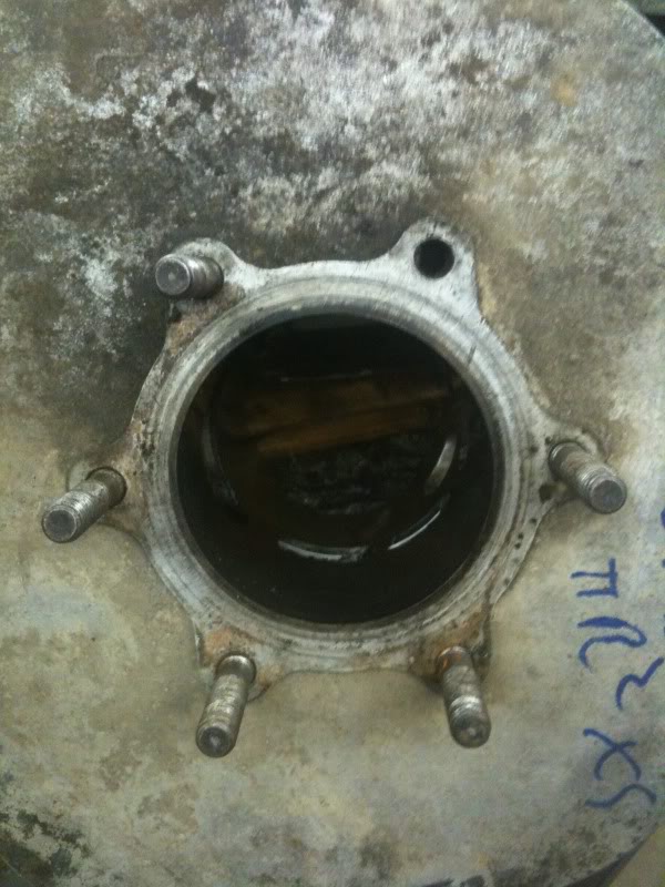

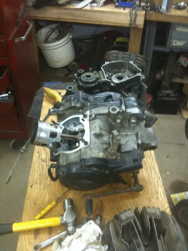

Ok so i got some work done today on the engine part... i have a 67.2mm bore looks like on my cylinder....and its in need of a overbore and a new piston... dont have the right flywheel puller to get the flywheel out..and the piston pin doesnt seem to want to come out.... i have some pics im uploading now of the jbweld job done on this engine case.. they used what looks like drywall tape to fix it with the jbweld..... Pics are uploading..

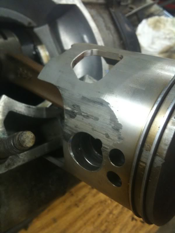

Here we go.... a couple shots of what i found when i started to take apart the engine..
Looks like the pistion pin is stuck...and the bearing is also fubarred.... so we are in for a new pistion and a bore..... on the top end..
Im already in for a set of engine cases... looks like ill need some of the other plastic covers for both sides....

the last photo shows some serious rigging (at least to me)... they used drywall tape and JB weld to fix the one engine case side........ you gotta be kidding me.... drywall tape?? maybe im a noob..but that seems retarded..
Well i dunno.. maybe thats standard... but im my mind.... if you gotta bust out the drywall tape to fix your engine... maybe its time to either buy a new engine.. or at least the part that is broken.... good thing i bought both engine cases instead of just the one side.....

Got piston and top end to engine shop.. piston was too small..the top end was pretty pooched, needed to go from 67.2mm to 68mm even.... had to buy a new piston again for $100.... was $75 for the engine service, they also threw in the missing head nut thing...... this weekend i started into the wire wheel on the exhaust... got most the surface rust off.. but its very badly blacked on the metal under the rust... so ill need to research the next step to bring that back to life...
