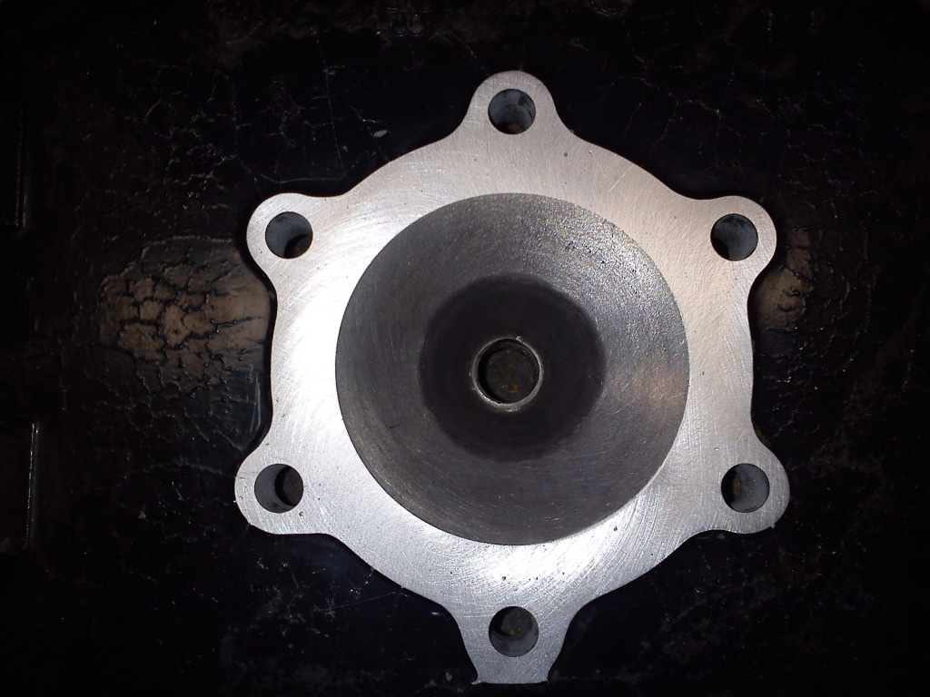

i am now offering shaved heads and fully ported cylinder and cr125 reed mods i will increase all airflow and will shave your head to have more compression i do not mill the head but i shave it the cr125 reed mod will increase airflow more than vforce 3 reeds will according to con8quest6 i will do all this for a low fee listed below shipping is not included

theese prices are low to start it off later on the prices will rise i am going cheap to start off my work here are some pics of it
here is the high compression shaved head

Have you measured the displacement of that head? It looks to be at 24cc's still. There won't be any gain of compression with a 24cc dome.
i shaved down the ridge to get more claerance if you notice the stock heads have a ridge on them i have taken the ridge out to gain compression so it will be closer to the piston
Making a smaller squish band will not increase compression. If the squish is too small, the engine that head ends up on will knock.
it will add more compression than you would think by shaving the head you will gain compression and the piston will be closer to the head causing much more compression
i checked tht it does not knock when in the motor but according to my compression tester it still adds compression
but the head is getting closer thus giving it more compression and making the motor knock people run flat heads and they dont knock i made sure mine didnt i ran this kit the other day and the bottem end and mid range power is amazing the tope end is speechless it wants to keep on going in top gear but down low it is really peppy and torquey
