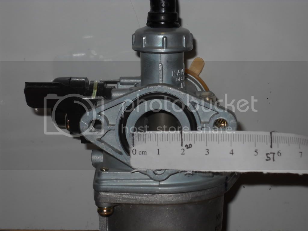

89blaster89 Member Aug 26, 2011 4,739 25 90 29 Pacific northwest, washington Jan 15, 2013 #1 where do i measure the size of my carb? its a mikuni
Awk08 Administrator Staff member Technician Jan 30, 2009 24,427 2,295 175 Usa Jan 15, 2013 #2 measure the inside diameter of the engine side.
89blaster89 Member Aug 26, 2011 4,739 25 90 29 Pacific northwest, washington Jan 15, 2013 #3 Awk08 said: measure the inside diameter of the engine side. Click to expand... inside diameter? do you have a pic? sorry im kinda confused

Awk08 Administrator Staff member Technician Jan 30, 2009 24,427 2,295 175 Usa Jan 15, 2013 #4 89blaster89 said: inside diameter? do you have a pic? sorry im kinda confused Click to expand... you're kidding right ???

89blaster89 Member Aug 26, 2011 4,739 25 90 29 Pacific northwest, washington Jan 15, 2013 #5 Awk08 said: you're kidding right ??? Click to expand... omg lol i thought you ment the inside diameter of the carb like inside the float bowl or something

Awk08 Administrator Staff member Technician Jan 30, 2009 24,427 2,295 175 Usa Jan 15, 2013 #6 as you can see, that is a 20mm scooter carb i found a pic of on google
DUALSTROKE Giving away free clues Technician Mar 2, 2008 5,263 427 134 masshole Jan 15, 2013 #7 Awk08 said: as you can see, that is a 20mm scooter carb i found a pic of on google Click to expand... Idk Might be a 21mm carb.The ruler looks a little chewed up.I:Ilol
