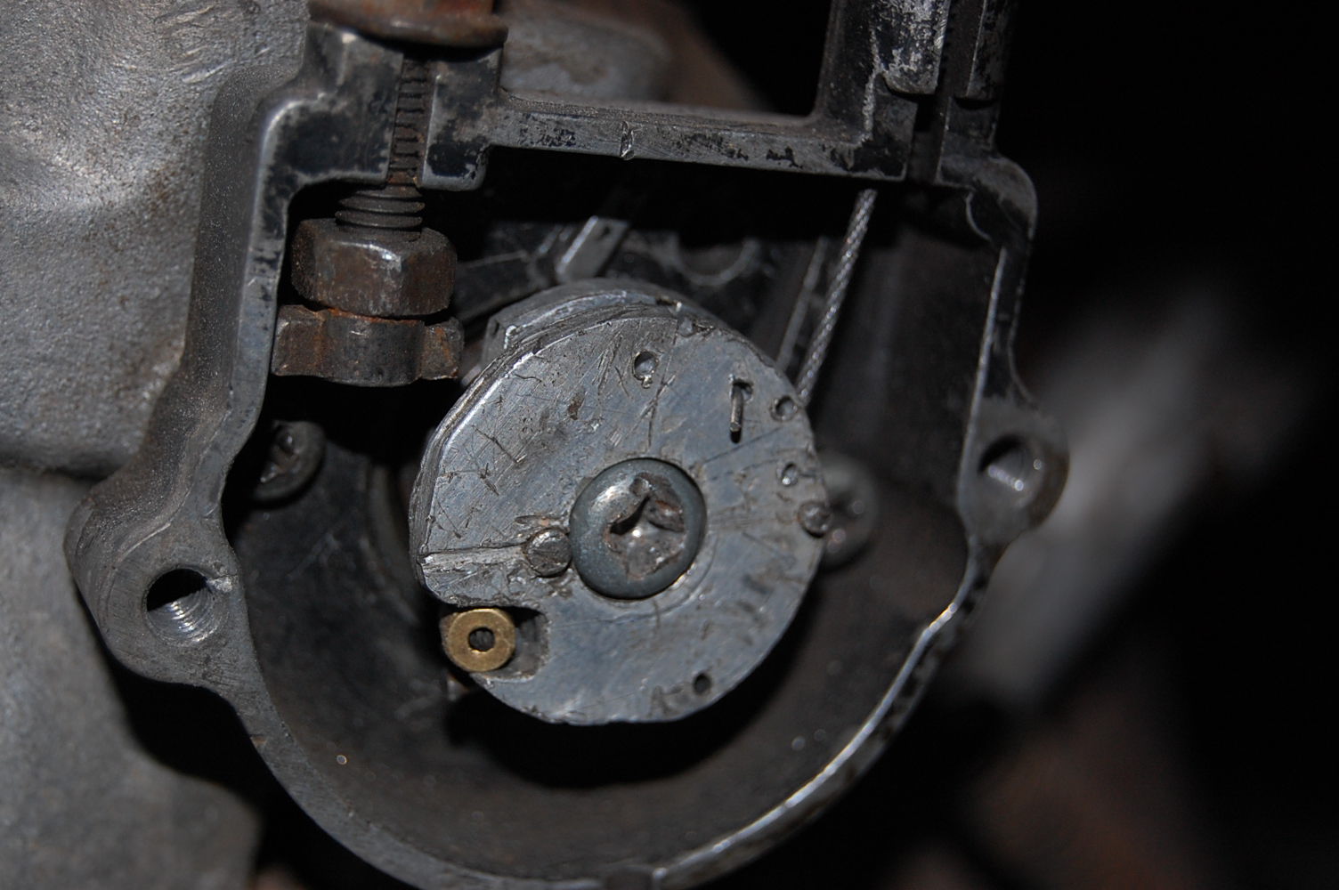

yo tambien entiendo poco la traduccion pero entiendo que ud no usa YPVS.una foto de mi YPVS
Uploaded with ImageShack.us
Translate: I also understand the translation bit but I understand that you do not use YPVS. a picture of my YPVS
Great picture, thanks! You have a return spring behind the pulley?
