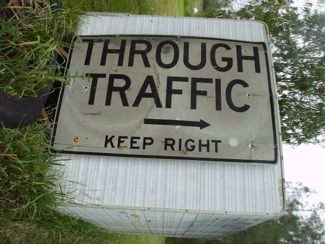

if u happen to have any aluminum consturction signs laying around they make great skid plates..just dont go out and be stealin road signs for a skid plate lol
Great donor material!
problem i found with road signs is they're not long enuf to tuck under the front bumper mounts, and still reach the whole way back
if my old ass memory still works...it takes 39 inches total
every sign i checked was only 36 inches
