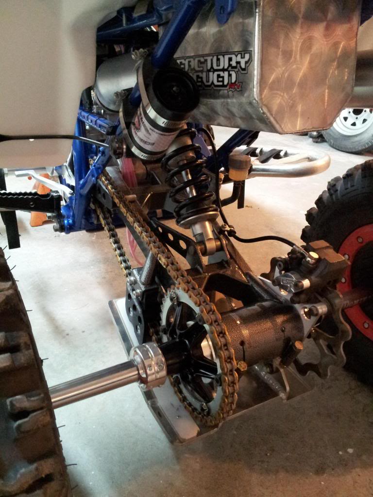

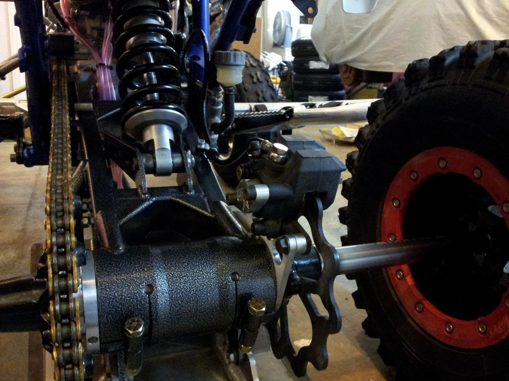

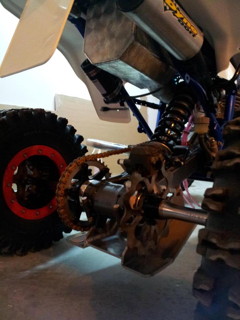

I don't know if this will help, but here is the LSR swinger with 03+ hydro rear brake setup. I had to get shorter length bolts for the caliper bracket, and I used the spacers that came with my RAD carrier to have the caliper sit right. I dont know if I got the wrong caliper mounting kit with the swingarm as the packaging said banshee on it, but in the end i made it work.
