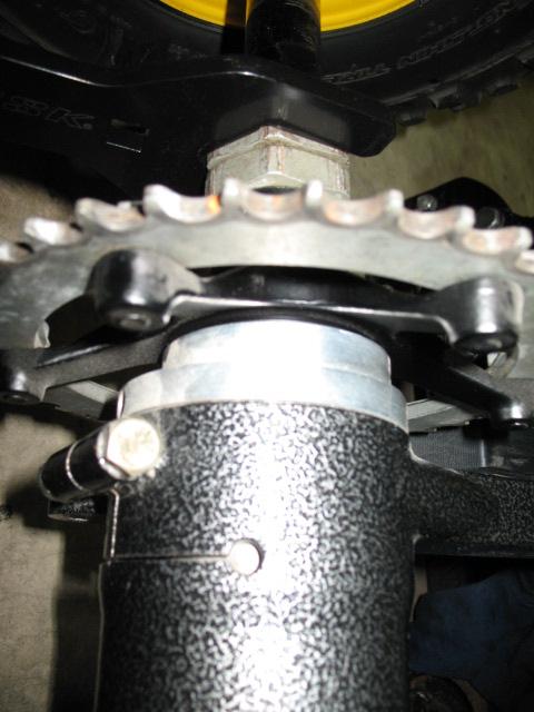

Hey guys,
Today I am finally buttoning things up on my rear end rebuild. I have a round housing rear bearing from LSR and the stock rear hub. I did the correct procedure for tightening the stock axle nuts but the hub seems to be rubbing on the bearing seal of the housing. its not bad and the quad rolls but i can hear it squeaking. I just don't want to wear out that seal. IS this normal did I do something wrong or am I missing a protective cover or something? I also could only back the inner nut off to about 140 ft/lbs not the recommended 170. there is no play in the hub. HELP! I DONT WANT TO DESTROY MY BRAND NEW HOUSING SEALS!

i'll see if I can get some up here for you. I am also talking about the sprocket hub. To me it seem that the inner part of the hub goes in just fine but then there is a larger diameter part of the hub that seems to be rubbing on the outter part of the bearing seal. like its too tight or something or just slightly pushed into the carrier too much. I have a LSR swing arm with carrier and a LSR axle.so that should be fine. does that make sense?
Idk everything came preinstalled from LSR. I"ll take it apart and see if I can push it in further though. but it seems to be right where it should be according to some pictures i can pull up in the internet.

Ya I think thats what I am going to have to do. I got pics to work. Here's the best I can do since I can't get the nuts off right now.
I called LSR. Their customer service rep was very helpful by the way. anyways, they said that it shouldn't be a problem and just apply some grease to the seal and the hub. I shot it up real good with some white lithium grease and seems to be just fine now. we'll see after a few rides. but for now its' not binding up like it was and no more rubbing/squeaking sound.
