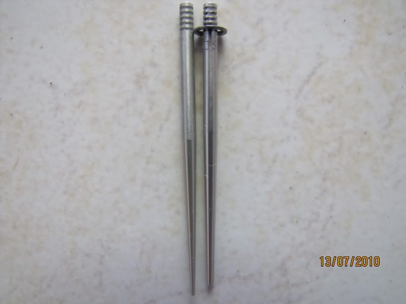

so long ago before i got my blaster back, i had bought a jet kit from LRD to go along with my pipe and in there was a longer needle. when compared to the stock one, it's the same diameter where the stock one ends but it's just a little longer and keeps tapering down.
is there any benefit to this? i swapped it over and haven't really had a chance to test it out because i can't ride at my house but it doesn't seem to be much different.
Taken from a jetting guide it seems to me changing length without diameter or taper change would act exactly like change the clip position. so in theory a longer needle would be leaner. be very very carful as this effect a large part of the throttle range!!!! Or a major rebuild will be in your future.... IMO put the original needle back in. Or at least verify verify verfiy jetting.

i would imagine you have a banshee needle in there, i ran a banshee needle with my mods on my stock carb and it was perfect, it is a richer needle.
does it look like this? Banshee needle on the right, stock blaster on the right...
Cant both be right!:-/
no no, it was significantly longer than the original. i went ahead and put the original back in because it was already running fine before the swap. might as well keep it that way. only thing that needs tinkering now is the pilot jet. i've got a little backfire going on and that's all i can narrow it down to since everything else is spotless. just going from a 32.5 to a 35 to see if there's any improvement.
