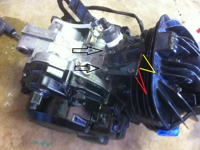

I have my project Blaster put together. Performed a leak down test and noticed a significant leak at the bottom of my reed cage. (see pic). I re-torqued the bolts but still leaking. I sprayed the paper gasket with Permatex copper gasket maker prior to install. Any thoughts?

why do i see gasket here (yellow)
but not here (red) ???
shoulda got the copper permatex in the tube, so you could lay it on slightly thicker than the spray gets in one coat, i never have a problem
did you use a 2 gaskets, one in front of the reeds, and one between the reeds and intake ???
i believe, of i remember stock correctly, the intake has a built in gasket, and doesn't require a paper one ???
Okay, I'm an idiot. When I saw your comment about the gasket sticking out I realized that I forgot the reed cage and bolted the intake directly to the head. (LOL) Back to the drawing board. I hope I can save the gasket. Whew, I hope that solves the leak!
i thought i saw the reeds missing, but figured my old eyes were decieving me
that somna-biotch woulda never started, minus reeds, LOL
