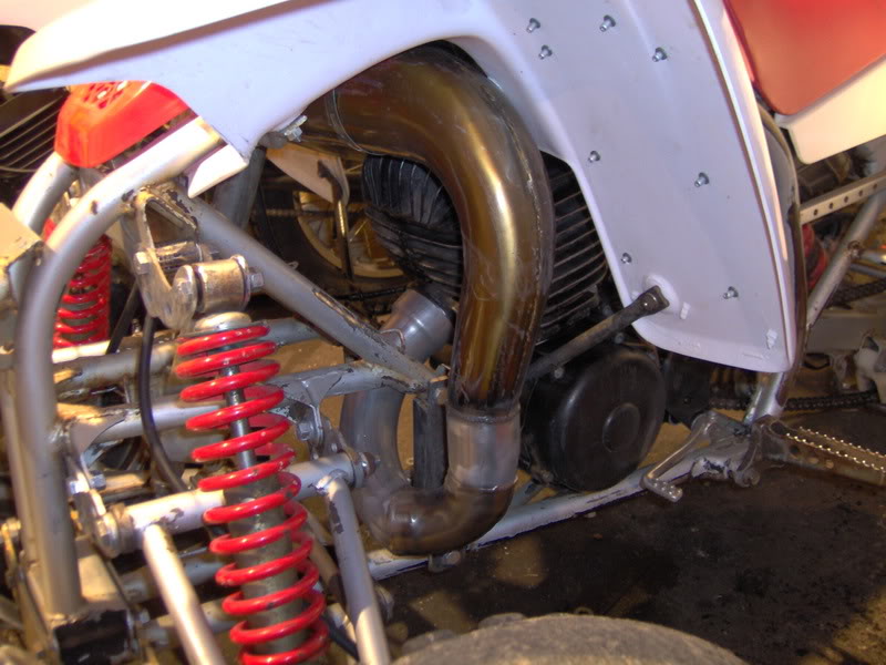

Routing the pipe. Will weld wedges in to get it to go where I need it:

The snow is melting here. I still haven't finished the pipe, air box or rear brake but
stuck a K&N filter on it and took it over the snowbank in front of the garage.
Wahoo! Shifter is in a good location, gearing is a bit high, engine and rad seem to be
tucked in nicely. Front cable brakes suck. A few good hard stops and the new cables
need adjusting. They stop it but have a terrible spongy feel and yet the drums are
grabby. Man, have brakes come a long way over the years.

Are you adding length to the pipe to get it to fit?
Adding length to the pipe detrimentally affects your top end. I mean, it's not like you need any more top end power... it is a dirtbike engine afterall...

With the pipe adding area to it affects the powerband no doubt.
How it affects it depends on where on the pipe your adding length.
As little as an inch in the head pipe area can turn a top-end pipe into a lowend trail pipe.
Yeah, I am adding length to the pipe. The 2003 KTM250SX motor tends to be a screamer with a sharp narrow harsh top end powerband. The powervalve is adjustable but the pipe and porting are biased toward top end power in this engine. My hope is to lower the powerband a bit, to better suit the heavier machine.
On the headpipe I have added a couple 1/4" wedges and added a 1" wedge on the fat section. I have a great selection of pipes, if this doesn't work well, I'll do another, trying to learn from the first. I just cannot fit a stock pipe unfortunately, due to the framework in front of the engine. I can theorize all I want, I won't know until I try it.

I'm not as well versed in the WAY that changing the pipe will affect the powerband. I believe adding pipe to the divergent section will lower the peak, adding length to the fat section will broaden the peak, so you might be well on your way with the modifications to the pipe to the land of sweet powerband.

It sounds like you got a good plan goin for the pipe. The wedges won't be a big deal and the lil addition your making to the head pipe could actually work out.
I'm really curious how it works out just for some insight. Vid is a must now my friend haha
For my 400 I used a DG aftermarket pipe. I added appox. 4" in the head pipe region no where else. It shifted the powerband LOW like off idle low.

All jokes aside, it's interesting 4" of pipe lowered the peak power that much.
Maybe best is onto something. Add about 1.5" of effective length to the headpipe to knock down a touch of that peaky nature.

Well, the pipe is done, no silencer yet, but it is welded up and I was anxious to giv'er a try, to see if the added length messed up the pipe tuning.
HOLY COW! Awesome kit! It freakin' honks! It still has a hit, pipe mods didn't kill that.
It is a bit low on torque on initial take off, especially compared to the stock Blaster motor,
but once the revs pick up slightly, it will readily loft or spin like a crazy fool trying.
This motor is brutally snappy in a bike and doesn't seem to have lost that quality.
I was hoping for more off idle torque but a lot of that is port timing, not changeable.
Gearing (14/40) is a a bit high on take off. I worry this may be a factor of the close ratio
motorcross gearbox so I am not changing it yet, until I see what the top speed is like.
Too high a first gear will not work well in our eastern woods where creeping and crawling
can often be an asset.
