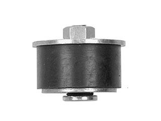

Its hard too see in there, like I said I am going to make a new plug and see what happens, the one jemes made was a little weak aroind the holes ro go over the bolts, I will just cut up a rubber boot and see what happens, maybe take the gasket that us shot out to see if I can get a better seal
for the exhaust, you need to use a plug like this
umm i would say a home improvement store like lowes or home depot or something like that.
it is called an expansion plug.
make sure you get the right size though.
