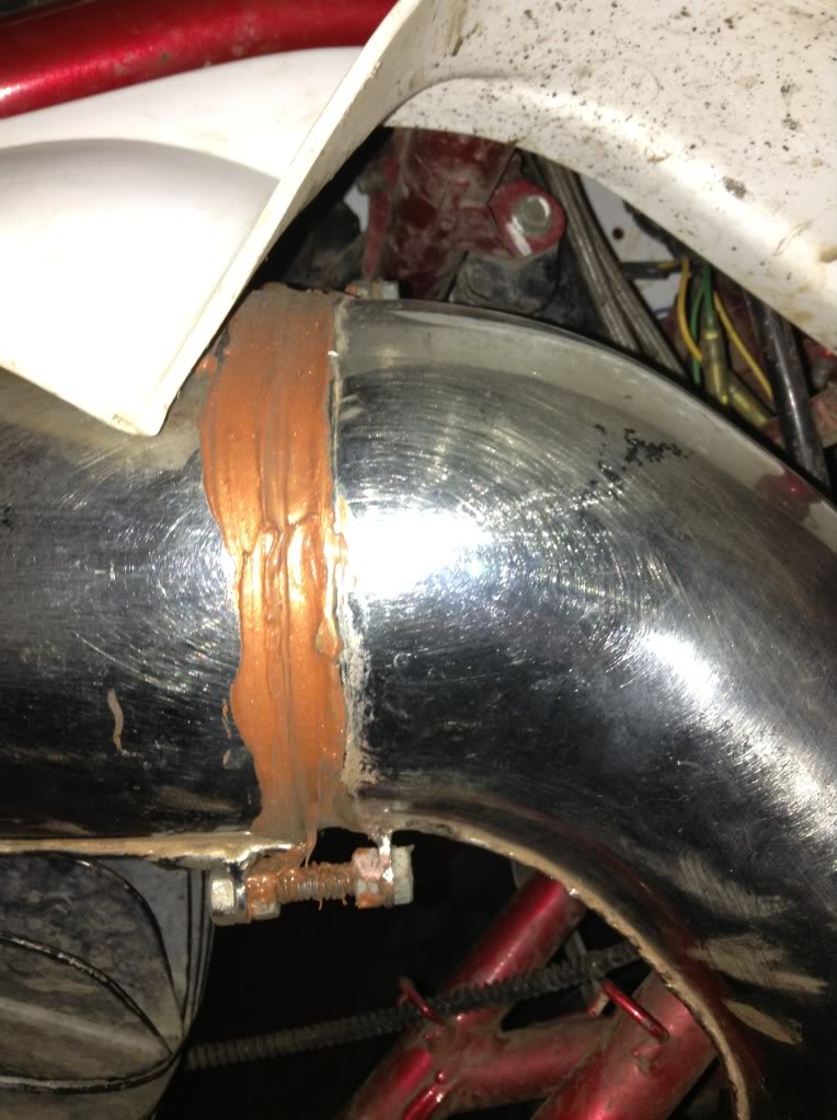

Word of advice for the LRD:

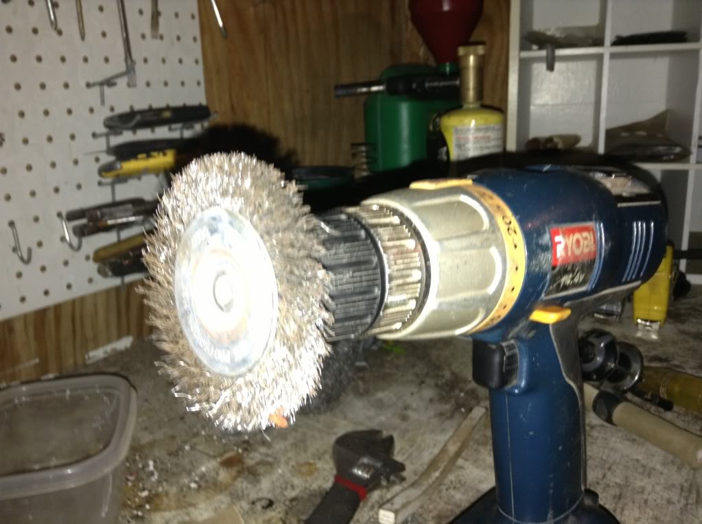

Get a screw gun with a wire brush wheel on it, and clean where they slide together VERY good
Use more sealant than you think, and add extra on the bottom of the adjustable spot
Put the sealent in the muffler pipe and slide onto the pipe, it creates a little ring inside and helps prevent leaks 20 times better I:I

I got my LRD, i have it adjusted to about half length, and i almost lost the handlebars when it hit the powerband and the sweet spot in the pipe I:I
Although, i think LRD is the hardest to get on the blaster...
Awk told me a secret.... Make it as short as it goes, take off the flange and you can twist it into the frame without taking it apart.
And after sealing mine 3 times, i learn another trick that will help you... Put sealant on both pieces of the pipe and slide then together, then smooth it out with you finger. (brake parts cleaner will take the copper sealant stuff right off your hand :D )
Also, take a steel brush thing on a drill and get a face mask and clean the pipe connections VERY well.... That was my main problem when i sealed mine...
Here is mine sealed:
Here is a good wire brush:
(No thats not the drill i use.... i had to use that one because our good ones are out in ND with my dad I:I)
