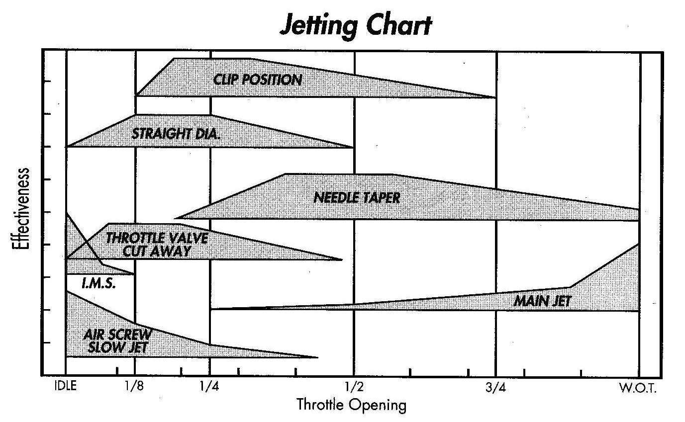

Jeting help by kennedy
this what your looking for?

Does anyone have the pic of the chart that provides you with what changes will affect the engines mixture vs. throttle position and its effectiveness that was in the beginnig of the post. If so can you please upload it?
Thanks
Nevermind, I just saw the pic is on his flicker page.
Thanks again Kennedy
