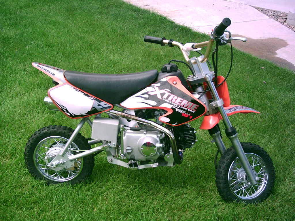

well do you guys think it would be a good trade if i trade him my 2005 extreme pitbike for the 99 blaster with the issues it may have??

now, as far as trade goes. yes, you have a cheap pitbike made from chineese parts. i used to have one for my kids and while fun, it broke alot and parts were a pain to get. the blaster will last you years and is quite reliable when taken care of properly. plus its much faster and has a TON of aftermarket upgrades and replacement parts on ebay. i would trade that in a heartbeat. it may take a little time and $$$ get get back to normal, but once you are there it will be more fun.

do u have any pics of it ?.. i would trade him cause i would think u would have more fun on a blaster then a pit bike ya kno ..
