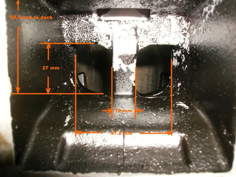

i wanna kno the intake port size on the blaster cuz i wanna buy a carb and i dont wanna buy a carb bigger then i need. because there is no point on buying a carb bigger then ur intake port. i would like it in mm's and i know the intake port isnt circular so could u give me all the dimensions?
out of curiousity once you have these given measurments how will you then translate this information into what size carburetor should be used in your application ? you do realize theres much much more involved into that equation than simply the intake size alone right ?
Here's sum rough measurements. If they're way off someone will correct me. Might help if you're tryin to figure area which is tough on goofy shaped ports. Keep us posted on what yur up to :)
