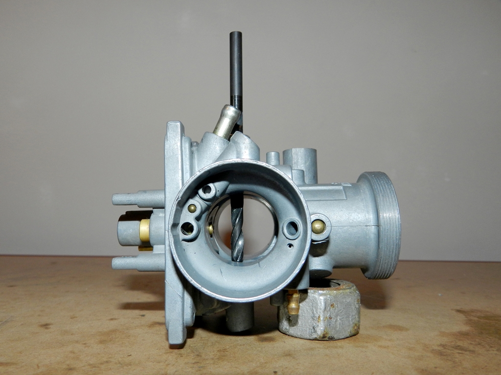

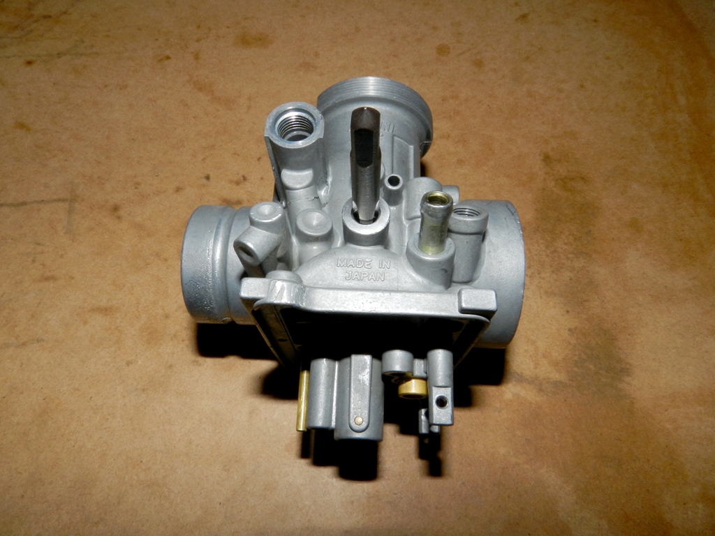

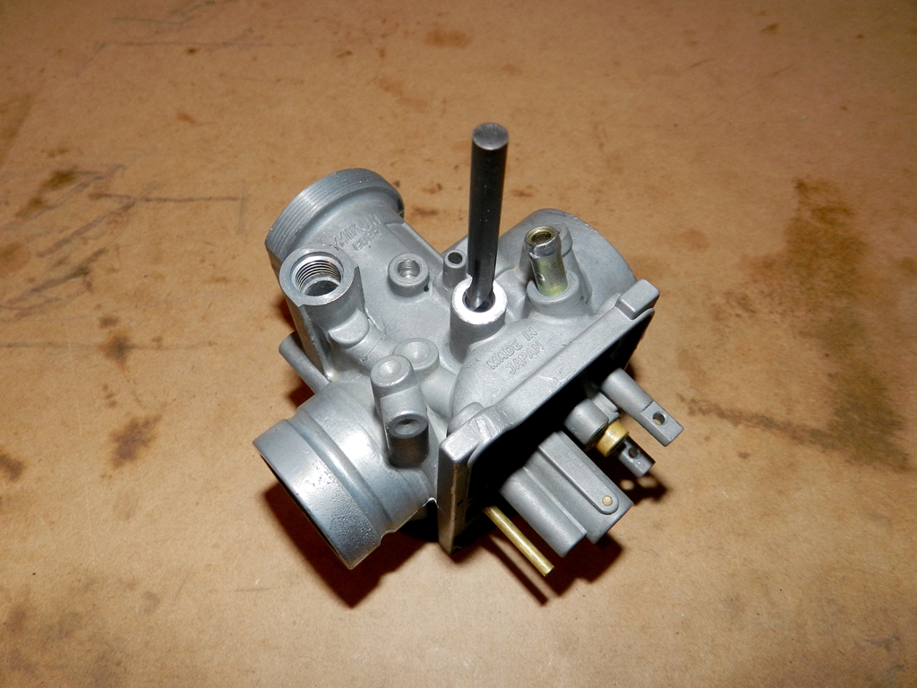

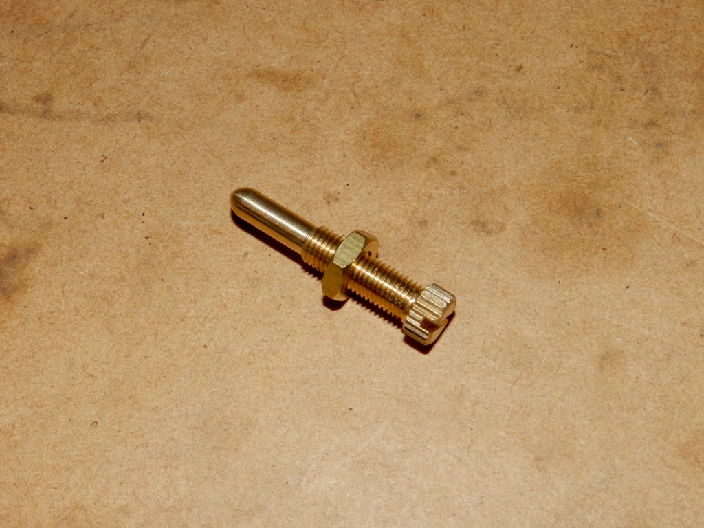

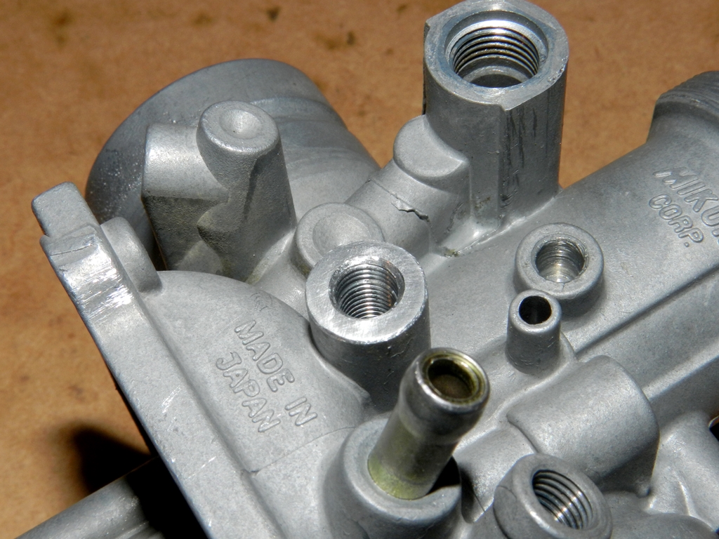

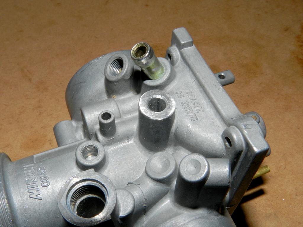

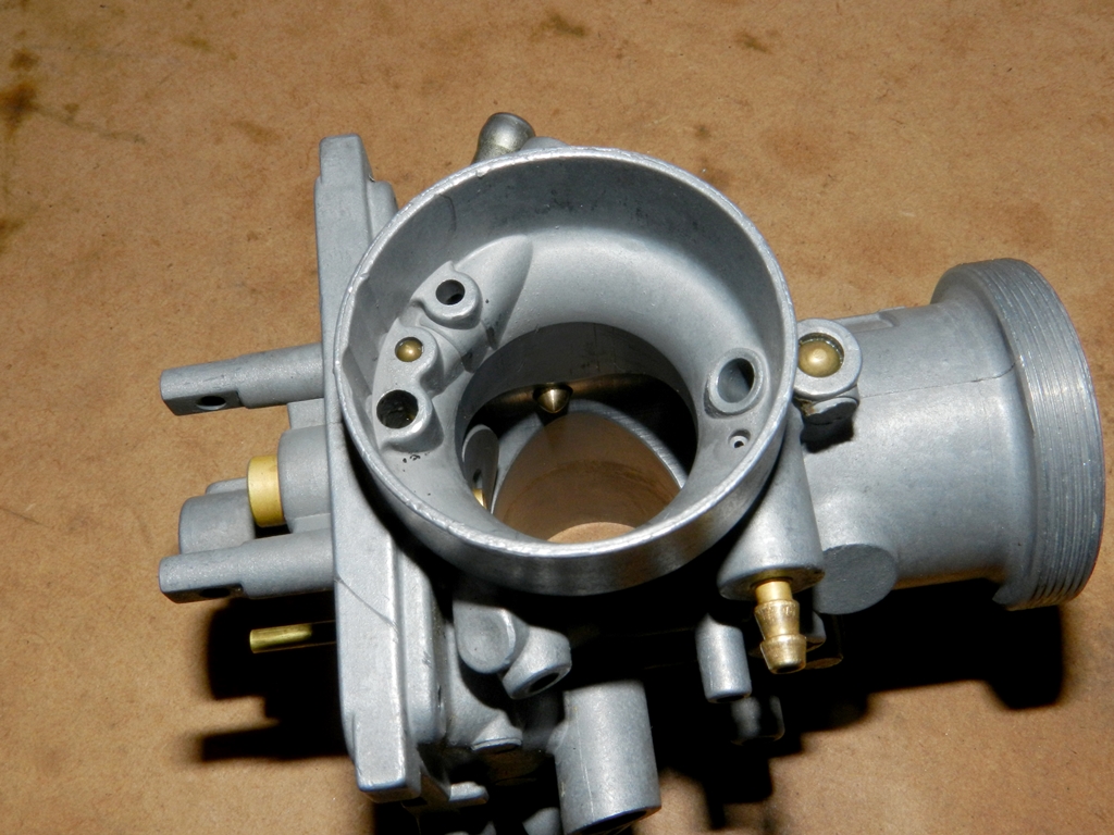

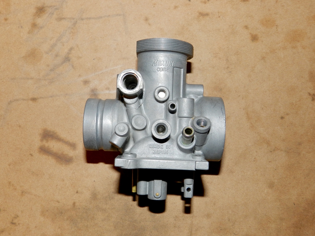

Got mine done today. :)
File flat to length.
Drill a hole in my nice carb. :eek:
Tab the hole.
Ready to install after cleaning the carb.
Installed.
Reactions: speedyslyder
