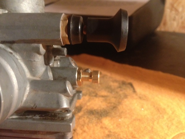

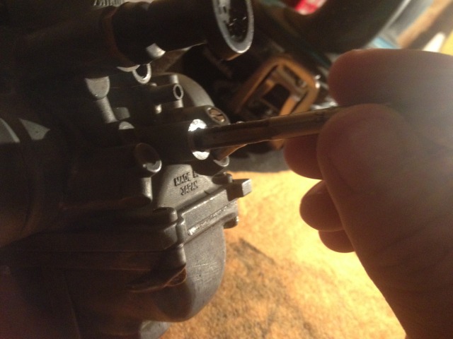

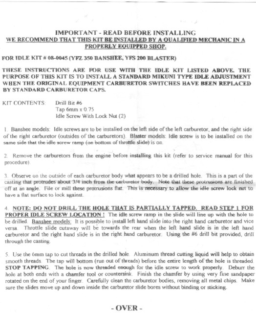

Hey thought this might help a few people, doing mine tonight looks as tho it should be hassle free!!
Here is some step by step pics also from start to finish takes roughly 20-30 minutes
just finished!

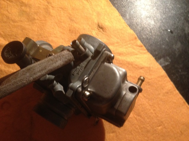

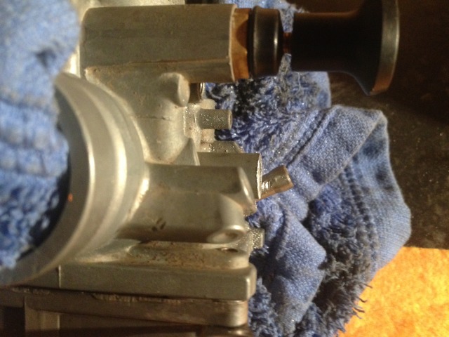

Some people will prefer to use a grinder but i used the old fashioned way(A file)
Give the finished edge a rub with some sand paper to take the ruff edge off

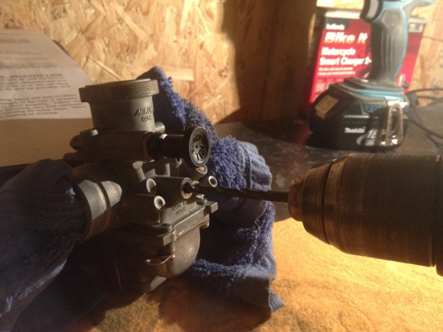

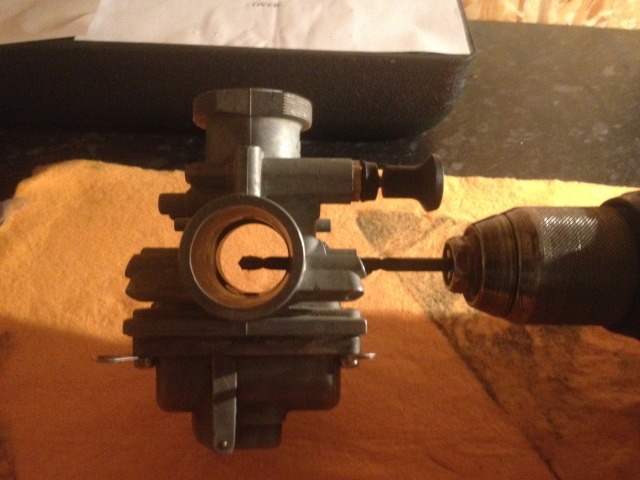

Unless you have a very steady hand i would fix the carb in a vice when drilling
and remember to put a rag through the carb to stop any bits of metal getting in to the carb

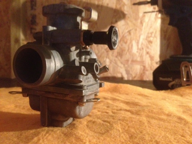

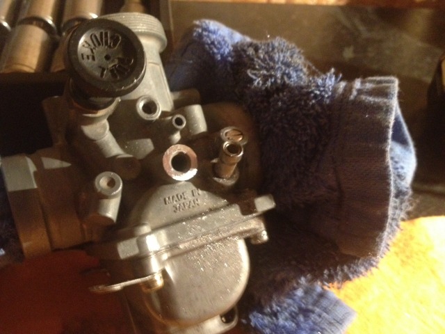

Ready for tap
clean the carb thoroughly to remove any metal shavings, And your done

i did file it down flat i am going to take the carb off again and give it a rebuild and check this again soon so maybe i missed something and will find it this time
does this eliminate the idle adjustment that on the throttle body you know that dime sized screw then cause where he drilled and tapped that... on my carb thats just a threaded hole that goes nowhere
yes, eliminates the idle screw on the tors box.

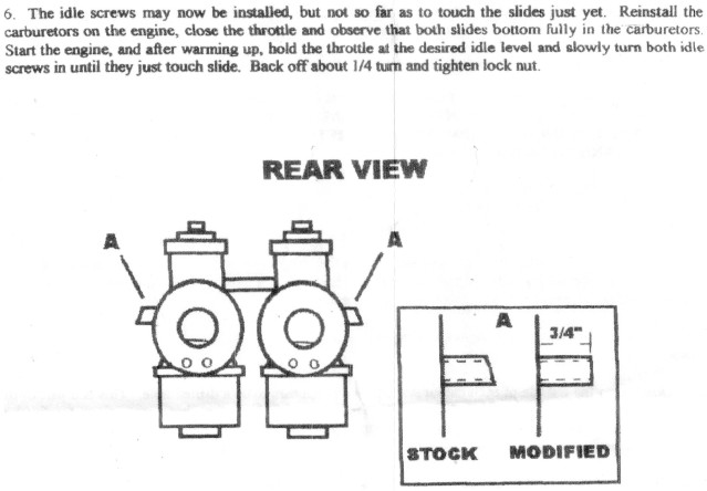

an idle screw gets added to that blocked off hole, it needs drilled thru, is not threaded, at least correctly, and needs the angled tip files flat
most idle screw kits linclude the drill/tap needed.
