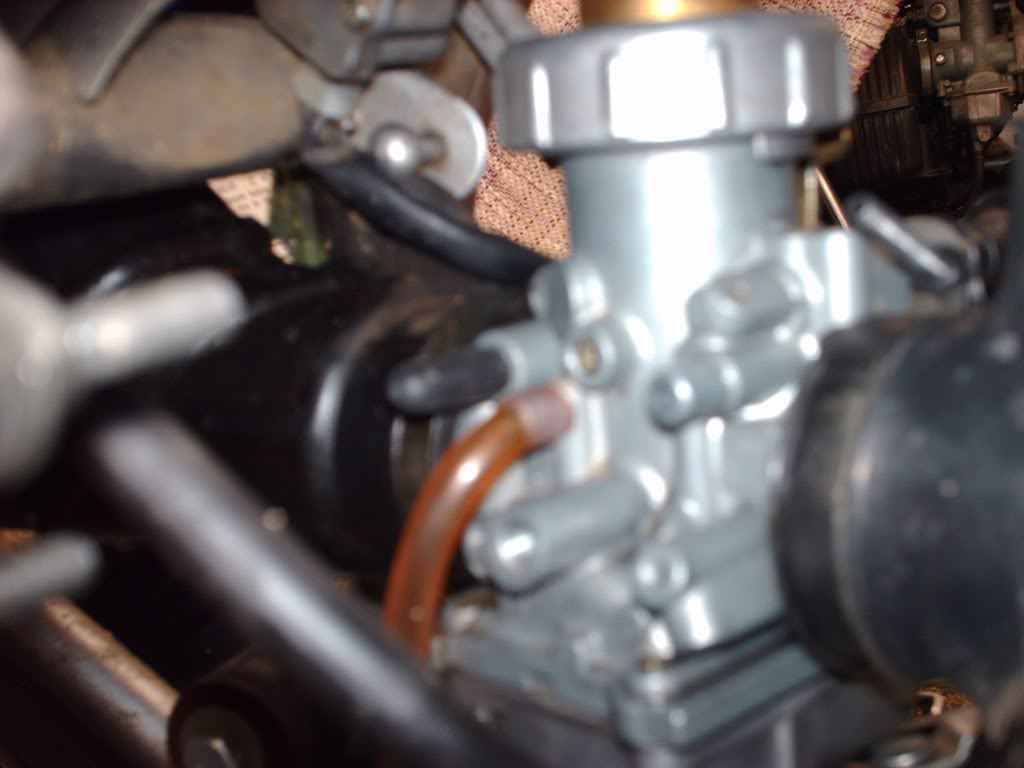

make sure when you block off the oil injection you put a vacuum cap on the brass nipple like this.
