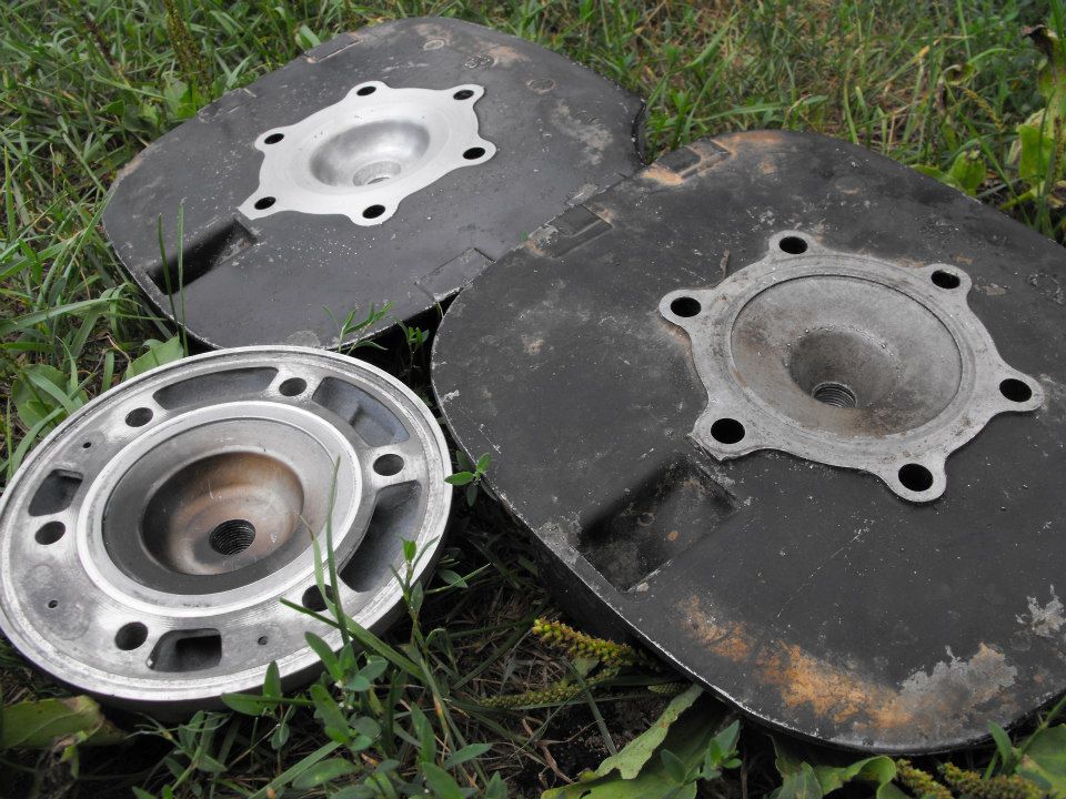

Modified cylinder head, ~18-23cc chamber, 1mm squish. Hemi or torroidal.
