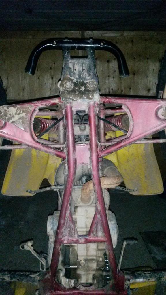

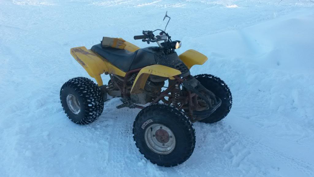

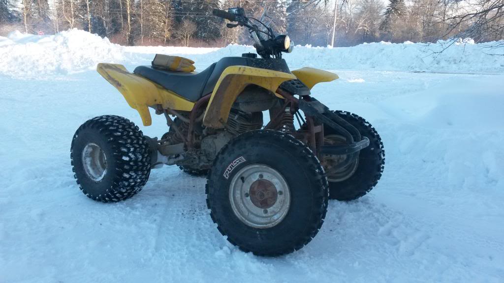

My blaster has stock a-arms and I've noticed that one wheel has some negative camber. It is the right side wheel. I know I need a wheel bearing on that side, I have the bearing I have just yet to replace it. There isn't a whole lot of play in it but there is some slight movement. Could that be the cause of the negative camber? Could it be a worn ball joint? Or am I looking at a bent a-arm or a bent frame? Are there any measurements I could take or any specific signs of some bending in the frame or a-arms?
You can't really tell from these pictures, I forgot to get some direct front end pictures to show the camber.

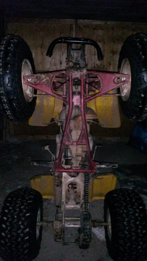

stand it up on the rear grab bar, and look at the bottom good around the A-arms, u can tell if its tweaked either direction that way, but i think your camber is probably from the bearing or a bent arm

Just to add a little. Look closely it may just be a slight kink/bend , use a small strait edge or square if needed..Sometimes the paint will chip where its tweaked. "sometimes"

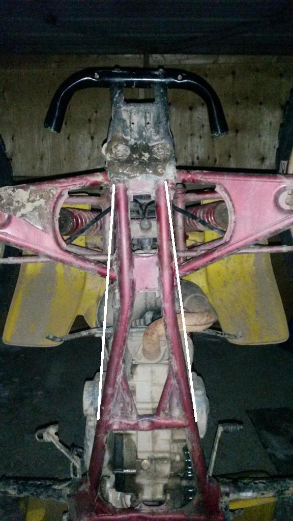

It seems pretty apparent that it's bent, is it able to be straightened out? Or do I just have to live with it? Any input would be appreciated.
I see the bend too but not sure how bad? Should be able to adjust your tie rod on that side to compensate? Good luck and hope you don't need a new frame!
i've bent to frames in this same spot............
you can adjust the tie rods back to straight alignment, and won't notice much in the dirt.
i'd be keeping an eye out for a cheap, straight frame to paint and start a full rebuild.
And the size of those dents in the lower frame rails, a skid plate will save a possible case damage in the future.
