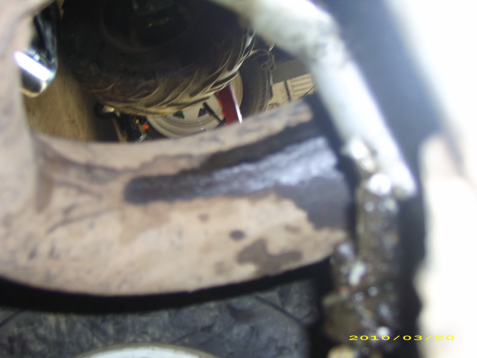

Hey guys me and my friend were out riding yesterday, and we were going through the field and all of a sudden is started smoking more then normal, i looked and there was oil on the pipe and all over the from end near the head, i drives ok, as far as i could tell, but me and my dad dont no what it would be, the spot were the most oil is, is like on the bend right out of the head,
PLZ help i dont really no why its doing this
P.S- going to try to see wha the problem is.. all the help i can get would be great
Thanks so much!
___________________
ATVkid2002
Comming out of the silencer and exhaust connector? Take a picture if you can that usually helps to tell where its commiing from :)
Here are 3 sorry for them being huge. :|
the third one is the oil everywere
did you put to much oil in the tranny.....might be oil from the vent tube under the hood this happens when you put to much oil in the tranny
Well i dont no on that, because the little window that i see the oil for the tranny is so small and dark i cant see were the level is, i look on the gears and there is oil on them so im good? i check oil all the oil tranny Ect before i ride everytime, but this is the first time its ever did it, and also it happened when i was riding.
appears to be a pin hole in your exhaust. That could cause some of the oil build up you are seeing. A quick little spot weld would fix that up.
Otherwise the rest of it could be tranny oil as the others have stated.
