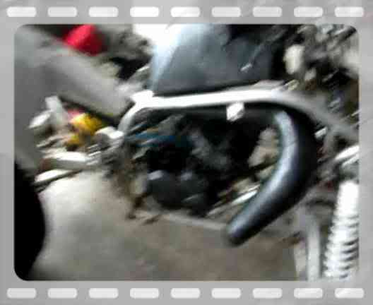

My guess is Crank Seals, anyone to help confirm
the silencer is rigged up in the vid so don't mind it
whats the problem? once your clutch gets spinning the oil in the window goes bye bye. and the smoke is probally from when you put it together
Well from my point of view it doesnt sound right, and its putting out a ton of white smoke seems like its burning tranny oil
hmmm, when i first got mine running it smoked a bunch too from the assembly lube and what not. were you trying to rev it up in that vid? i thought i was just idleing
leakdown test is the best way to verify its a crank seal, or if maybe its a problem with seal between the cases
building a leakdown tester isn't too expensive. and its the only way to know for sure where the leak is.
then its time to start begging mom and dad to buy you a few bucks worth of stuff. should've taken my advice and saved that 41 bucks you had a while back so you could get stuff if it didn't run right
I'm a 15 year old kid with no money and not old enough to get a job lol
First off, you are old enough. Second if you say you have no money to build a simple leakdown test, how do you plan on buying new crank seals? Do yourself a favor, save some money, build a leakdown tester and find out what your problem is. There is absolutely no point in ripping apart your motor, when there could be nothing wrong with the crank seals.
