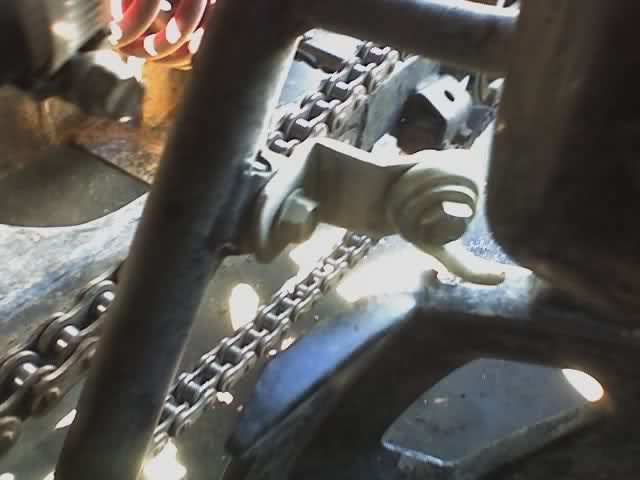

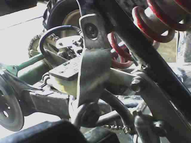

heres pics of the brackets i made....................
shifter side................
kicker side....................

cut some 1 1/4 to 1 1/2 inch cardboard strips first, and use them to shape and length that you need, then copy/trace the length and bends needed to the metal
the shifter side is just a 90 degree bend, then a slight kickback to match the angle of the yfz mount rod
the kicker side is about a 30 degree bend, then a full 90 degree twist to match the mount
be sure to heat(not melt) with a torch whatever your bending/twisting, especially aluminum like i use, to prevent it from cracking
