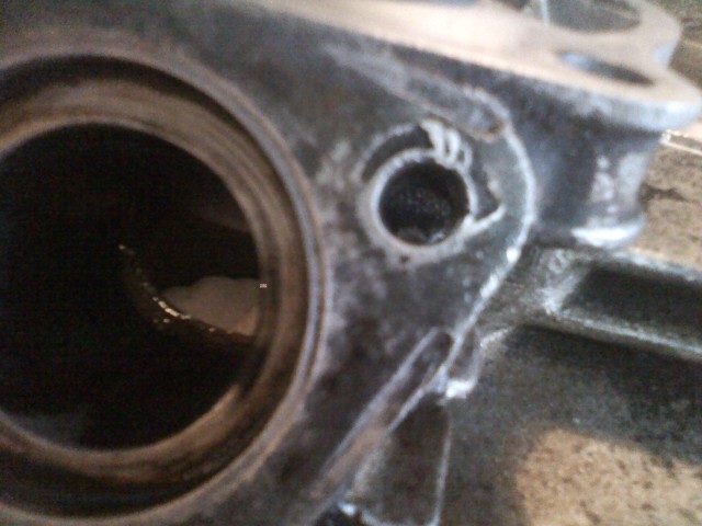

Ken, how much do you charge for the CR500 stud modification? I have a fleabay cylinder I've been cleaning up and the holes are either stripped, marginal or heli-coiled. The exhaust flange is stripped too, what is the trick there?

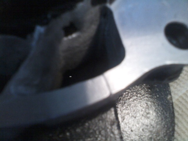

Also there is what looks to be a casting flaw on the gasket surface but it could be a tool mark. Should I worry about this sealing and if so is there a fix?
Sorry the pic is terrible, the groove isn't super deep or wide but you can definitely see it and feel it when you run your fingernail across it
