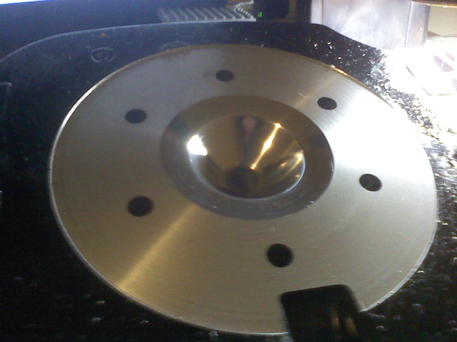

this is the only 1 i got, it wasent cut to the full extent, some meat was left on the bone so when i get porting it can be re-cut again. it made a pretty good difference in torque though i have to say.

That looks really nice. By looking at the depth of the cut,I would guess it CC's out at 23CC's? Squish band width looks to be about 40% of the bore (like the DT200 head).
This will promote "Top end scream" in the upper part of the power band.

sweeeeeet, it will be nice for whenever i get porting and it will be nice with my right bend pipe
The best thing is to install the head and do a compression test to see what the number is. Post the numbers too help determine if its going to be safe to run with pump gas. It does look like the mounting area has been shaved down a good bit.
I can tell by looking at it that its around 22cc to 23cc chamber volume. Static compression measured by the gage will only tell you so much. Exhaust port timing (height) will determine what your compression will be. A re-chambered head has to be matched to your porting. If its a very small chamber volume,you will be needing an increase in port timing (exhaust port height).

Not correct. I run a re-chambered head (150 psi compression) on "premium pump gas" with ZERO detonation. I have cut many of these heads and tested them all with excellent results. No need for "Race gas" with a properly cut "re-chambered" head that has a squish band and proper squish band clearance. A re-chambered head prevents detonation from happening in the first place if designed and cut properly. You also won't need any +4 timing advace mods either. The head does that for you too.
If you mill,or in other words,remove material from the sealing surface of a STOCK head design for an increase in compression,you WILL,without question, run into detonation ,and will reqire "Race gas". "Race gas" will only be a band aid for this situation,and you still won't reap the power benefits that a re-chambered head offers running on "Premium pump fuel".
