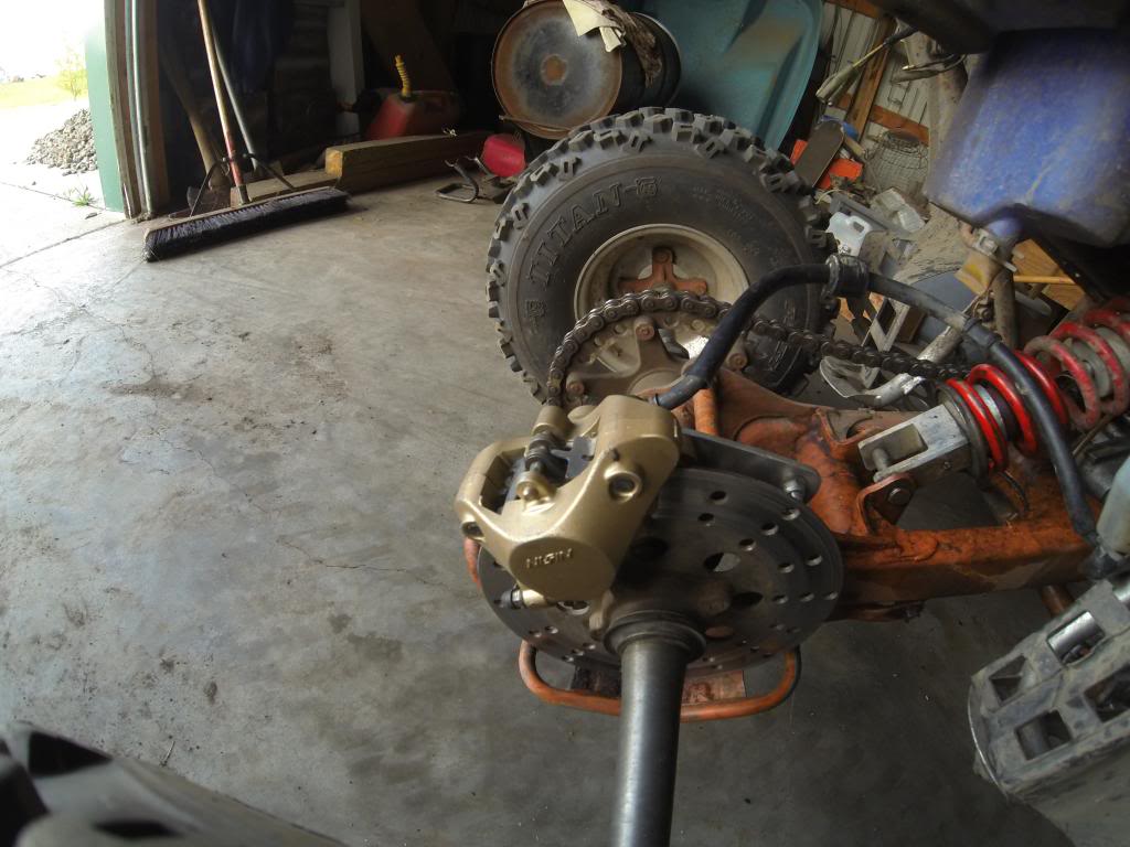

alright today i got my new clutch in (3rd time's the charm I:I) and put my AWK rear brake on also
pictures I:I

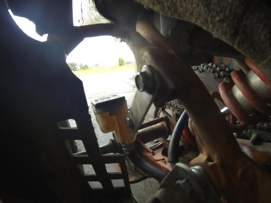

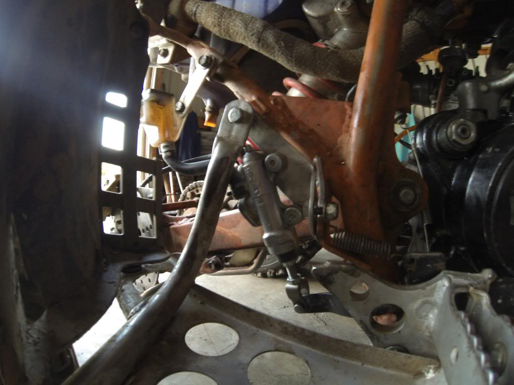

brake
is this where this is supposed to mount???i couldnt find another place for it
Also some shock pictures..... as i never got any for you guys
ok good, wasnt sure..... yeah i had to fight it alittle on the piece that has the.........(the thing that the pedal pushes... name escapes me right now) but got it in the end.
The master cylinder. Yeah it looks good. Probably a pain cutting all the zip ties off, but I wanted to make sure you would know where to put them.
