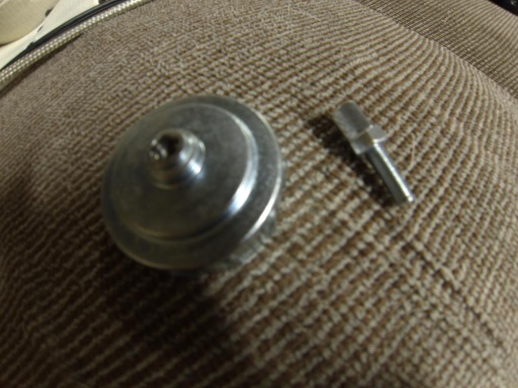

well i got a carb cap in the mail today:

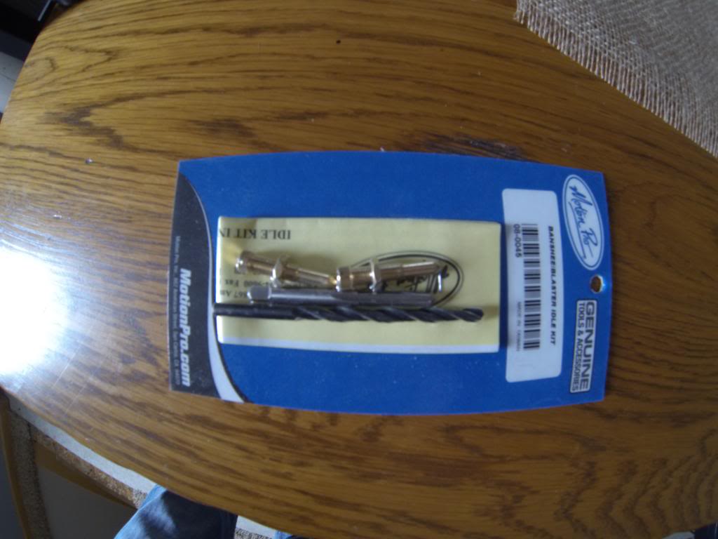

now we both are waiting for the idle needle kit to get here to finish removing TORS
got our needles in today..... and since its snowing super hard.... will probably be installed soon to.
bought the banshee kit for 2 needles, it also says banshee/blaster on it to though
well i got that done, didnt go to well....... ran-away on me.... cause the slide got stuck at 3/4 throttle had a grain of sand in between slide and carb wall, so had to take all apart and clean that out
but now finally done, so im now TORS free I:I
