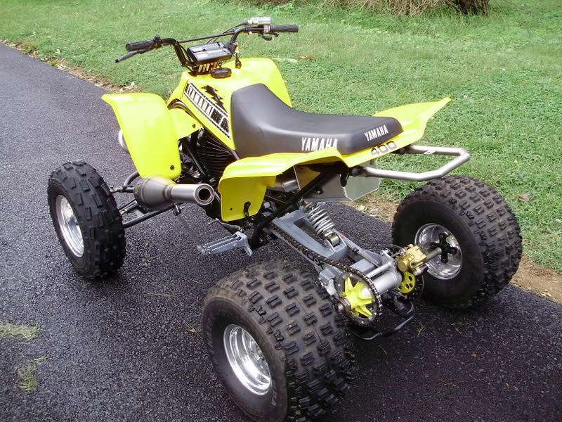

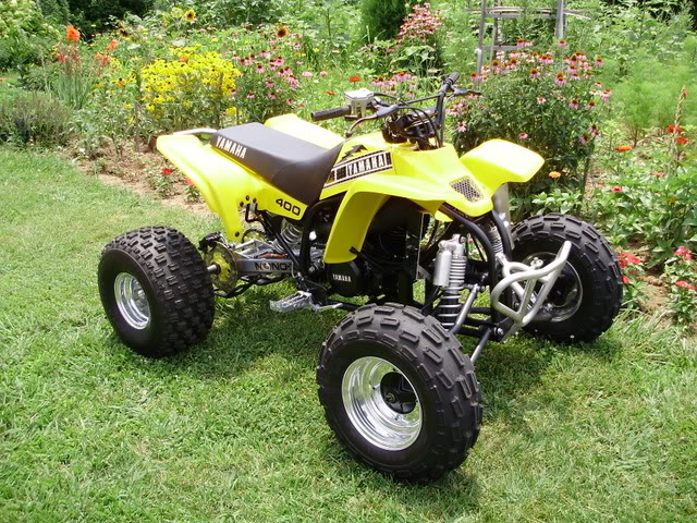

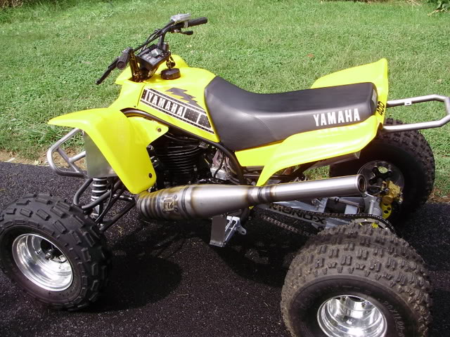

It's a 79' YZ400 in an 88' Blaster frame.
I built it to look like what the legendary Bob Hannah would have races in the 70's.
In the vid it has a Flotek trail port, FTZ custom pipe, V3 reeds, 14/40 gears with 20" Kenda Dominator rear tires on a +4 swingarm.
Up front I have ASR up 1 +3 extended A-arms.
Out back are 03' CBR600RR hydro brakes with the CBR rotor and pedal assembly.
Heres some other pics
