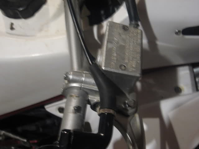

front brake resevoir
Would it hurt the cable if I kept It like this.
P.S. the bars are temporary
+1 on not level as long as your not bleeding the system. And that throttle cable may bind after a while of use. I wouldn't run it like that but it's just my 2 cents.
Because that will change the point of where your at full throttle. Whe you set up a twist throttle you want the throttle to top out at a comfortable position not your arm in a twisting down motion.
As long as it doesn't suck air, it could be mounted vertically. Your master cylinder is no more than a hand actuated pump with a couple of checks in it.
