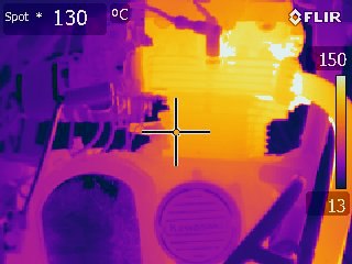

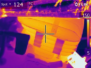

We can run it on Neil's DT200 bottom end and pump.
And test it out with the FLIR Gun.

I just don't see a point in water cooled on a blaster, but i sandblasted my jug and left it bare without paint. This kept it allot cooler.
i cant wait to see what the results are iv wonderd if they made a diffrence or not
