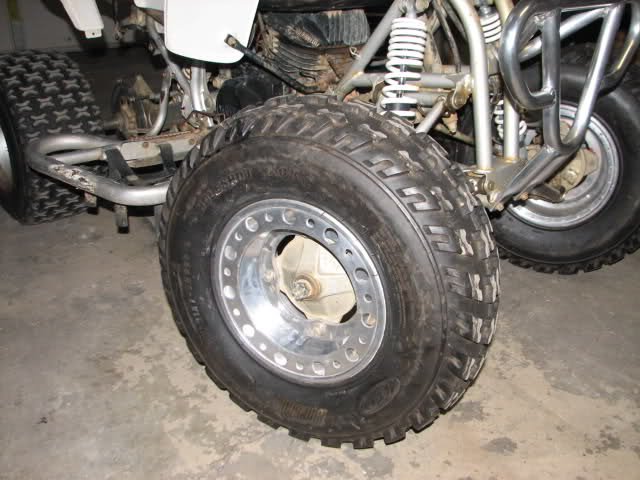

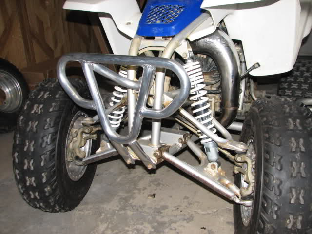

Just a couple teaser pics. I was not going to install anything that I was going to need to take back off when I tear it down for paint but I was getting bummed with the lack of progress. So, I decided to bolt on my new front wheels and tires, Banshee shocks, and front bumper. Noticed the Banshee shocks were about 1/2" longer than my stock ones. The action feels so much better. The rear really looks like it is sagging now. Cant wait to get the z400 shock put on now. Hopefully it will help level it out. Head is shipping out to Ken Oconnor Racing tomorrow for redesign.
everything is looking gd man! those rims are really nice!!!
Thanks. Yeah the front look so good that I just cant bring myself to paint the rings like I did on the rears. Got some paint stripper today so I can strt stripping the paint off the rears and start polishing them.
