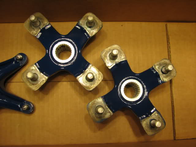

Will get some up tomorrow since I have the day off work. Has been kinda busy the last couple days. Have to repaint one of the wheels. Rear Hubs, sprocket hub and brake caliper bracket are done. Started to spray clear on it and the black reacted with it and cracked. Not good but at least I only sprayed the clear on one side of one wheel before I saw it.
Well here are the pics as promised. Had to srtip and repaint one of the hubs twice because it just wasnt coming out right. The surface was a little rough for some reason. So far have the sprocket hub, the rear hubs, and the rear caliper bracket done. The frame will be getting done in the same color. One rear wheel is finished also and I picked up a couple 18x11-8 Holeshots today to mount on them. Need to try to get a decent amount of work done this week because school starts back again after the first of the year.

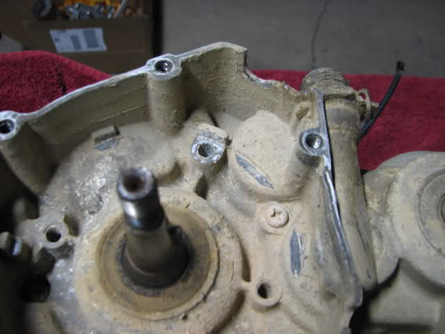

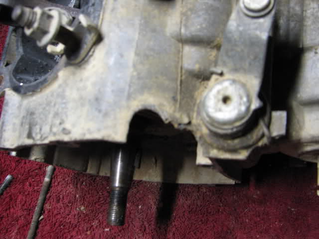

Case broken where the stator wires come out. It had been "repaired" with silicone.

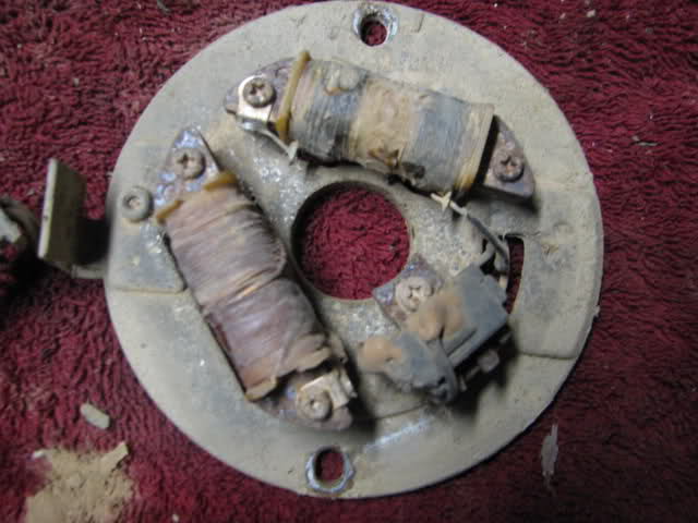

Stator was covered with dirt.

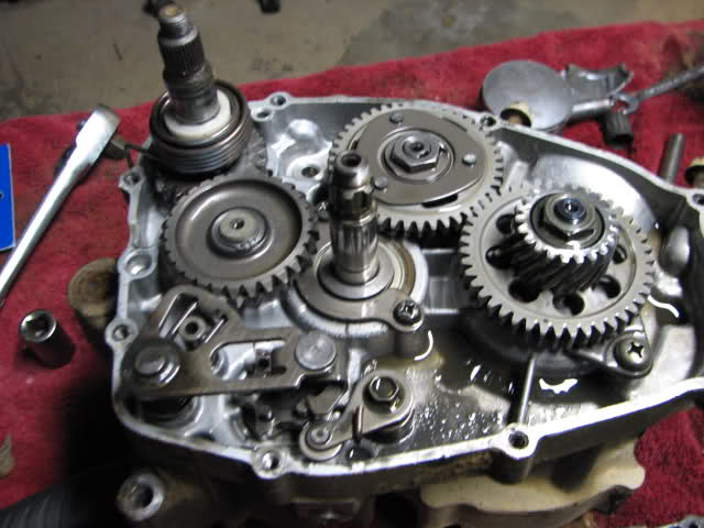

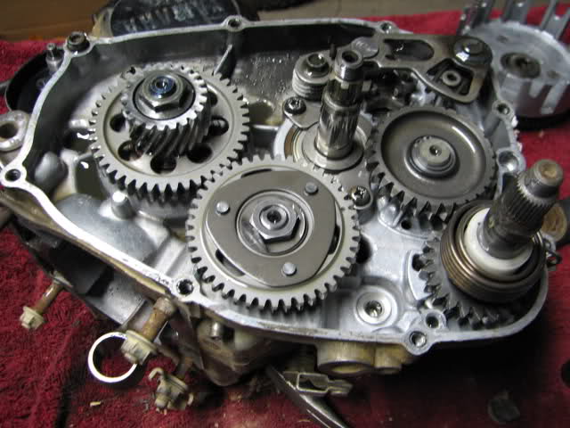

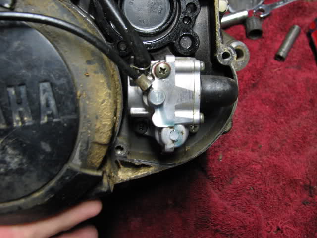

What is that??? Thought I would remind everyone what the oil pump looks like be fore I toss it in the round file...

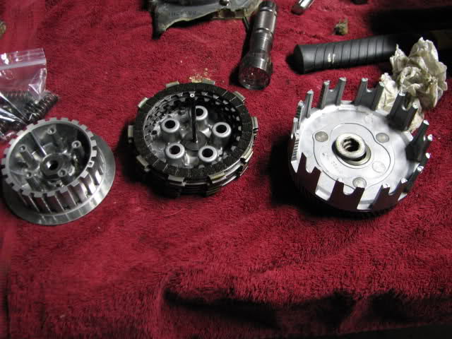

Clutch cover is off.
Clutch plates "looked" good. Basket only has very light grooving starting. Should be able to smooth it.
Looks like a good place to stop for the night.
