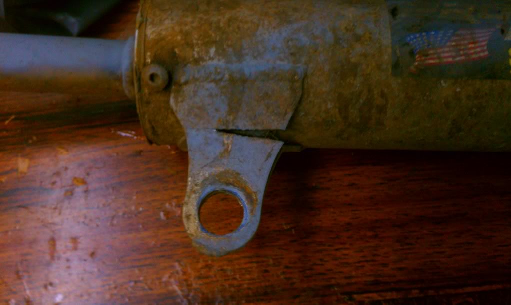

warmeck Member Dec 25, 2012 601 13 54 Connecticut Apr 4, 2013 #1 what do you guys think about this slice in my exhaust? how should i go about cleaning it up? its pretty dirty
Wheels Member Dec 6, 2012 522 8 54 Washington Apr 4, 2013 #2 Take it to the local muffler shop, they should be able to fix it for around $10
L Larry's Shee Active Member Technician May 23, 2009 9,271 1,057 149 Ortskaville, MI Apr 4, 2013 #3 Clean it to bare metal on both sides about a 1/4" back for a good weld.
B blasterfast New Member Apr 14, 2013 40 0 0 Arizona Apr 18, 2013 #4 Welder up take it to welding place probly do it for free its very small.
mud runner Member Jan 19, 2012 3,314 29 90 28 leabnon TN Apr 18, 2013 #5 or get 2small pieces of metal and put it on both sides of the cut and put bolts in in it but welding it it a better option
