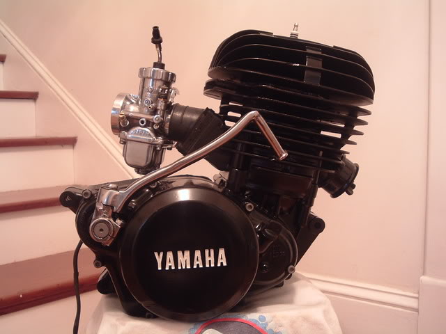

I swapped this motor into my Blasty with pretty good results. The vibes are easy and the power is rediculas.
79' YZ400

As an example the 79-90's big bore YZ's were all based off the 79' YZ400. Other motors from the 70's use some of the same parts too. The Banshee motor is really from the 70's and started like in a street bike. I use a Banshee clutch in my 400 but all the big YZ's will fit. YZ490 rods are plentiful and work in my motor. An IT425 jug bolts right on and 465-490 do too with case machining. IT425 IT400 YZ400 cranks all work. All Ballz makes bearing and seal kits.
