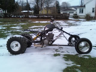

4130 chromoly chassis built by me.

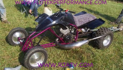

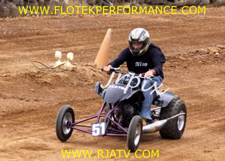

engine has a 3mm vitos crank that has been trued and welded. running a 1-5 overide tranny. has a rdz lockout clutch with a modded clutch cover by me. some engine internals have been modded by yours tuely..ct sonic 72.25mm cylinder ported by denny mears at flotek performance. nology coil and hotwire..v force 2 reeds..keihin 39mm pwk carb..k&n fliter..rdz pipe..+10 swingarm by me along with a 4130 wheelie bar..geared 15/33 for 500ft of dirt. has been down 500ft. in 6.7 seconds at 83mph..this was at BLAIR BEDFORD DIRT RACERS INC. alot of 500ft tracks are faster.
