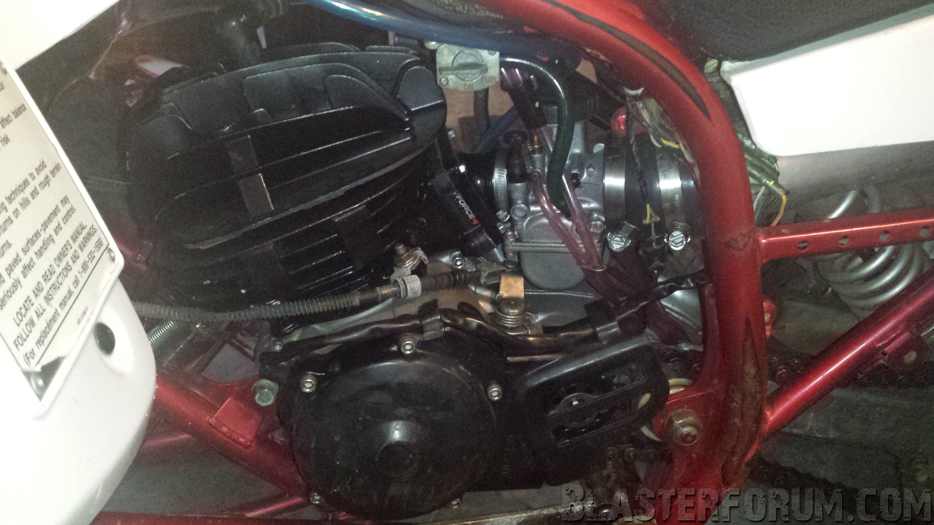

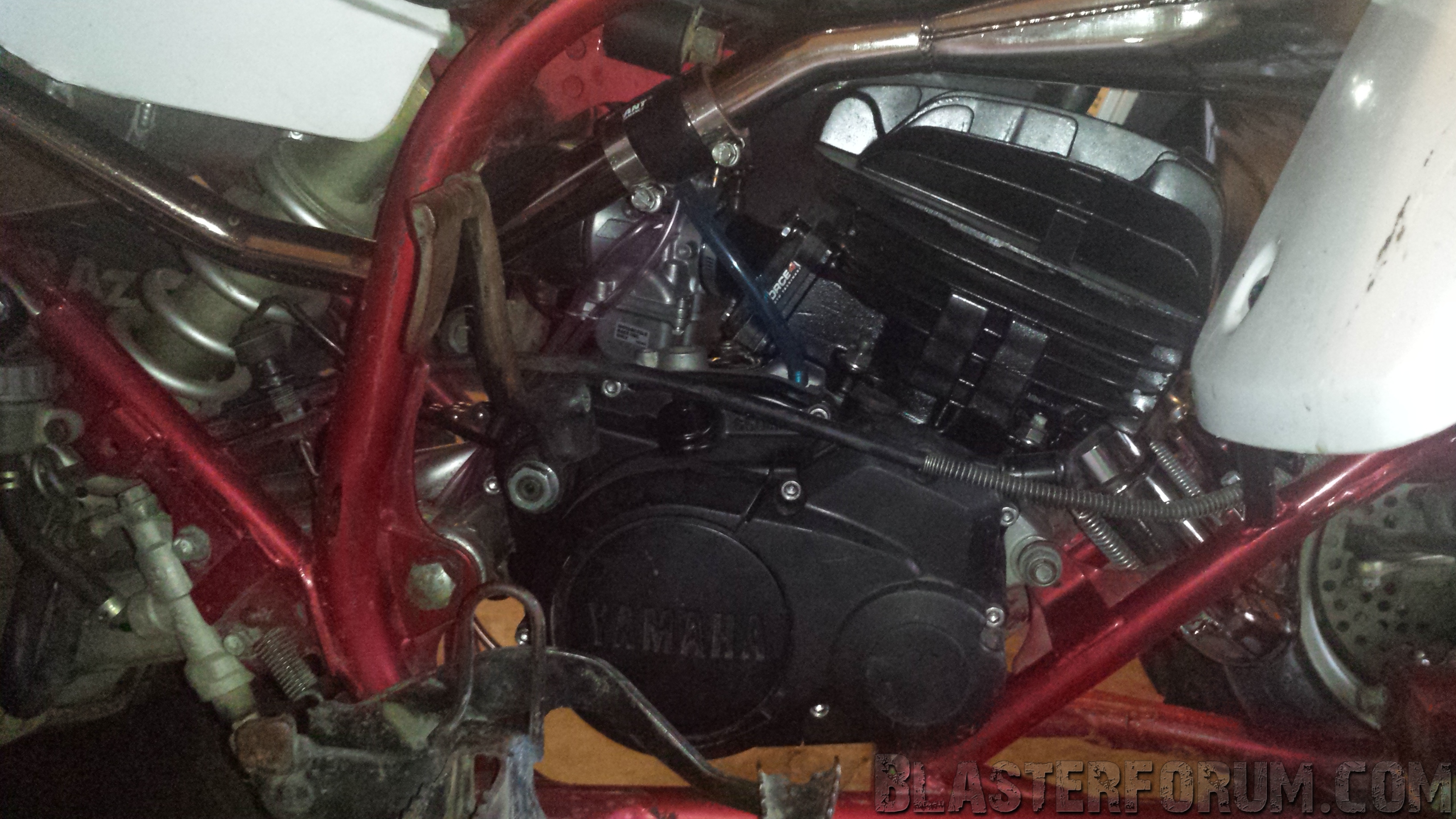

did you ever post up close pics of yur setup?
not that we need to see it but it is interesting lol:)
Let me know if anything stands out. This thing was bought in pieces in a box and most pieces were missing. I have not put the final zip ties and tuck on the wires yet so please don't hate the temporary spaghetti mess I have going on. I just didn't want to clean it up just to have to tear it apart so I am waiting till all is well to put the final details. But if there are any problems let me know.
That's a keihin carb not a mikuni so the jetting will be completely different than a stock carb.
I would put the needle clip in the middle position and I would think the 50 pilot is way to big for that motor. You should be between a 42 and 45 with the air/fuel screw 1 and a half turns out. The black screw is the idle adjust screw.
