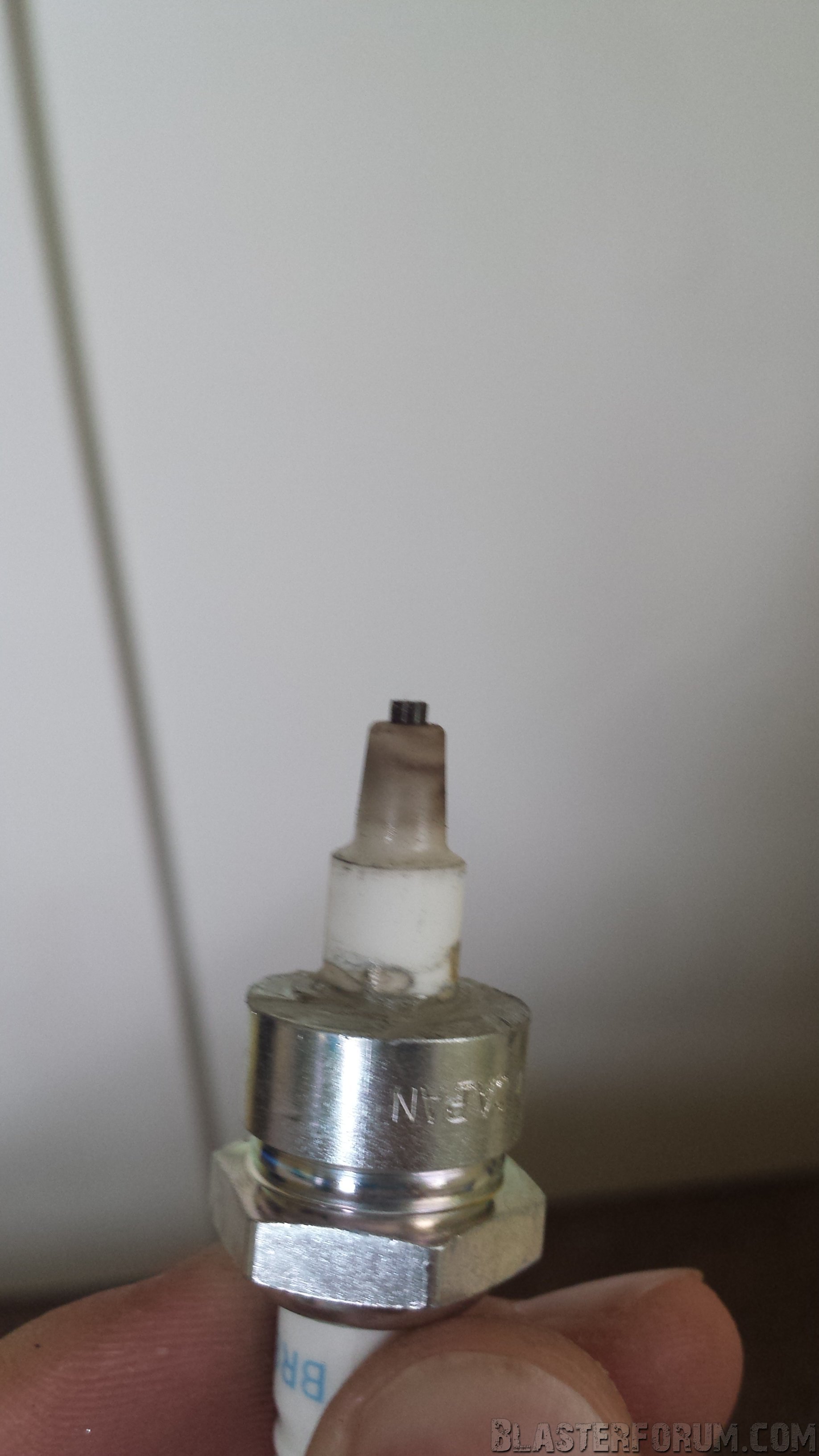

Having your needle in the #5 bottom clip position makes it rich, and looking at the jets your running i would guess its running rich. But your plug chop dont look rich???
Read this, it talks about the needle clip position, diameter, taper and length. If you look at the little chart it will show you how much of a range the needle clip position effects. http://www.blasterforum.com/threads/jetting-the-keihin.46341/
