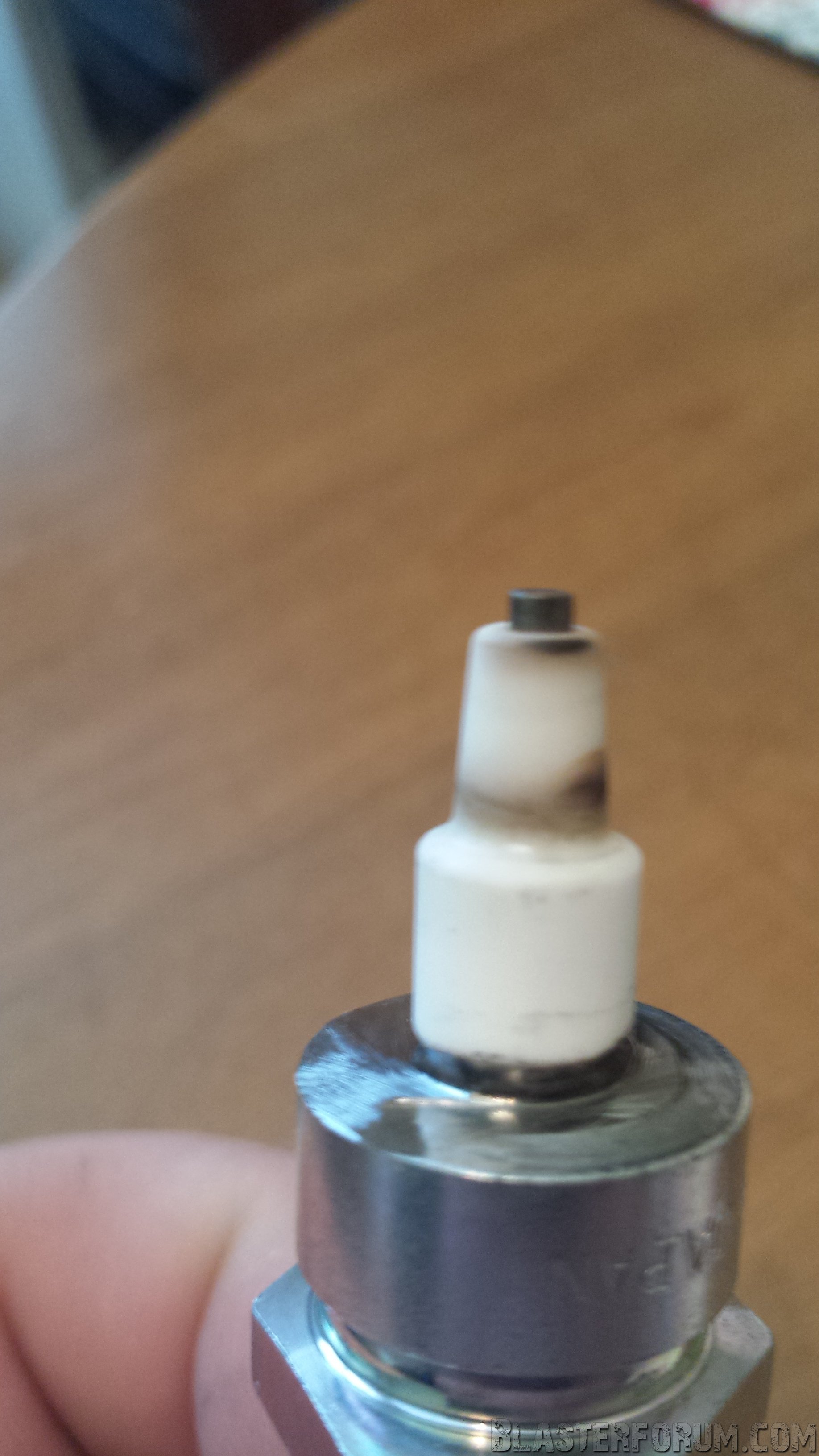

I get what your saying. That's kinda what I was getting at with this whole thread. It started because I know what a Blaster should feel like because I've been riding one for 10+ years and know that it has a hard kick when you hit a high rev. I had to yank the handlebars to try and wheelie in 3rd gear when my dad's much less built blaster would do wheelies in 3rd easier. Mine didn't have that kick up top, kinda like a small 4 stroke, it had some power in all revs but never unleashed that 2 stroke throw you back power when you hit the powerband in the high revs. There was a difference in power from the transition between 1/2 and WOT but not a screaming throw you back difference. I was always waiting for it to kick in and throw me back but it just didn't happen so I knew something was off. I just didn't know what because you guys were saying my plug chops looked fairly good with the last ones I posted and jetting is the root of 75% of all issues you ever have on these (I'd give user error 14% and electrical 10% and 1% miscellaneous). In this case it was my plug chop pulls that were wrong (I hope, if not then I gotta dig a little deeper to find it).
I raised the clip one position to the second to last one and did a REAL plug chop pull. I held it at half throttle for a full 20 seconds with the brakes applied so it was under a decent load in 6th gear. I didn't think to check spark while I had the plug out so I'll do that another time. I will run to the farm tomorrow where we have a grinder to chop the threads but from what I can see just by looking down, it looks like it's got a nice dark ring on it. I'll post picture when I cut the threads.
use a flashlight and magnifying glass to veiw the smoke ring, no need to ruin a brand new plug, now that you know what you're looking for.
cutting off the threads is for rookies, which you are no longer :)
I'm not confident in my color reading yet so I don't mind ruining a $2 spark plug to get you guys' opinions.

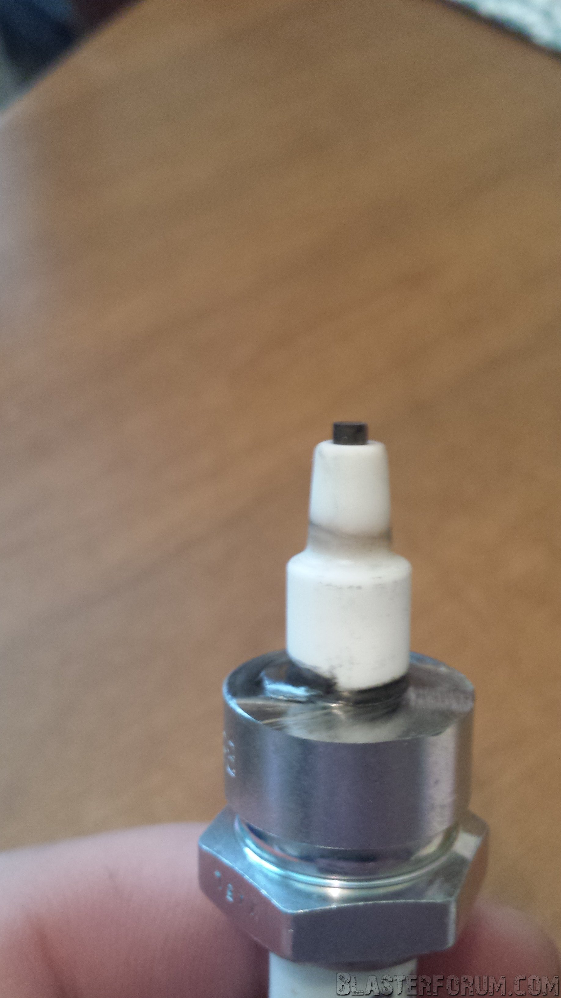

Here's my half throttle plug chop at 2nd to last clip position. Full 20 second pull. What do you think?
There's a dark spot on it. I don't know what that's about but the rest of it looks like the first picture
looks good to me. I'd do another main jet plug chop now that you've leaned the needle
I thought that looked good but don't hurt to ask. I was gonna do a main plug chop after I confirmed the needle was good.
