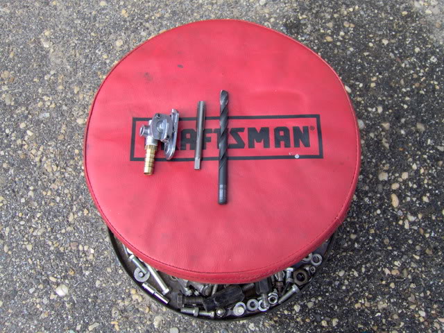

What you need:
A drill and bits
A tap
A hose fitting
Dremel (optional)
Bigger fuel line!

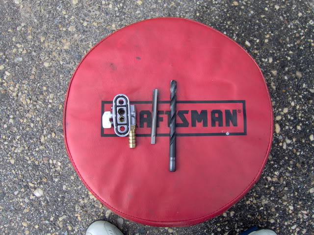

Begin by going to a hardware store and picking up a hose fitting. I found this brass one from True Value. Pick up a matching drill bit and tap if you don't already have one and bigger line. True value littlerly has a rack of lines. Trial fit the hose fitting and fuel line while your there. For this one I needed a 10mm-1.00 tap and matching 23/64" bit.
Remove your petcot and drill out the stock brass fitting. Step drill it starting with a small bit and work you way up to the 23/64" bit. Run your tap and screw on your new hose fitting.
Disassemble your petcot and take out the front plate (it's the piece that says RES, OFF, ON on it) You'll see a stop that's inbetween RES and ON on the right side. Grind the stop off. This will let you select RES and ON at the same time giving you twice the flow.
Remove the in tank fuel filters and tubes. Drill both holes out on the top.
I scribed a mark on the selector plated marked 'B' for both RES and ON.

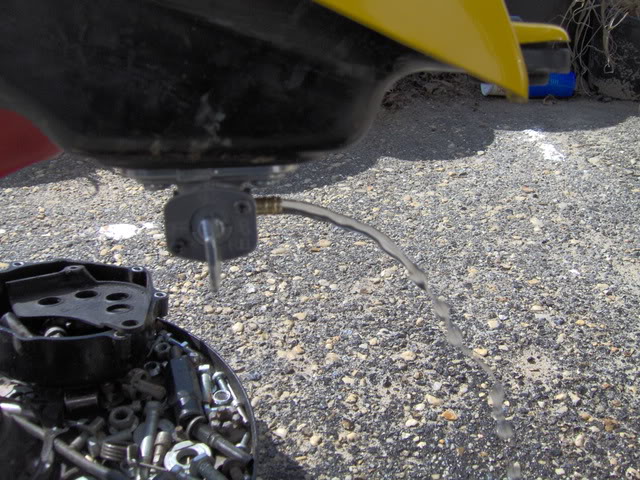

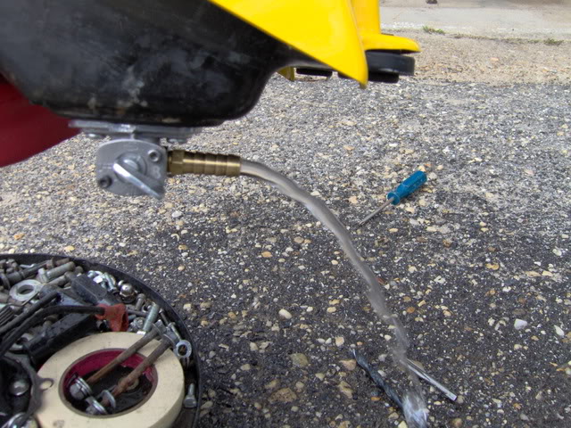

Stock VS Hi-flow

You better believe that's water :)
Yes it does help. The stock Blaster tank fuel outlet will flow less then the fuel inlet of an aftermarket carb.
After this mod the only upgrade is to drill out the inside of your carb or get a pump.
