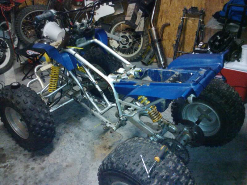

Recently I read a post in the Body section what a fella slid his plastics back and it looked pretty good. I decided to have a go at it as it stated you only needed to "cut the trunck out and thats it", not to discredit his post but there was ALOT more involved than that. Here is the steps I took:

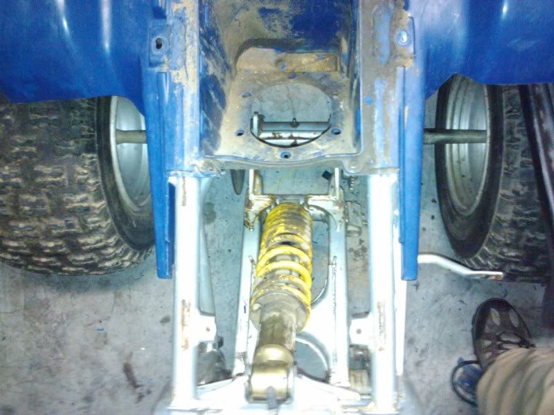

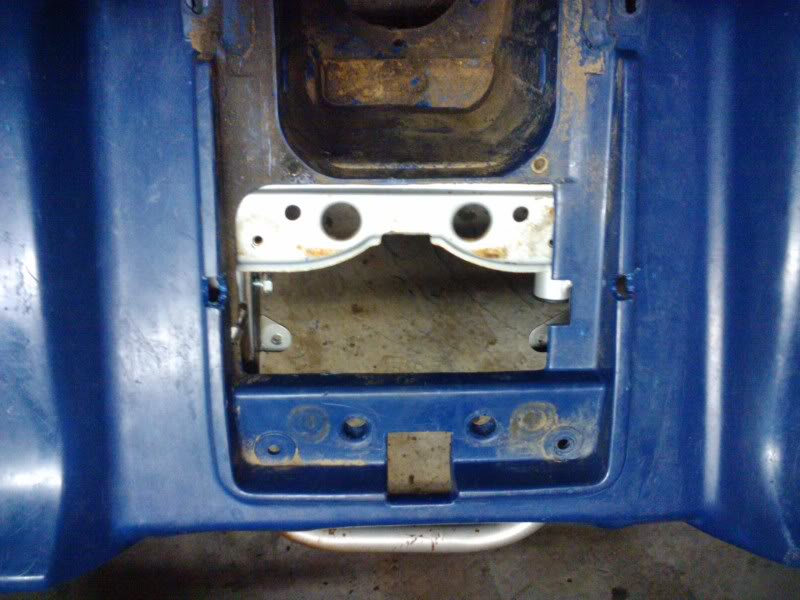

1 - Cut out the trunk box at the 90* angle where it becomes vertical. Clean up all the edges ( I used a box knife ) and get all your line straight.
2 - Remove the front mounting holes ( where the plastics use to bolt up ) This is very easily done but dont cut too close to the air box or remove any material where the bolts come in from the bottom.
3 - At this point you have began to notice that if you push down on the front of the plastics it rocks back and forth about 2 inches. If you try and put the seat on it either will NOT lock in the front or the latch is not long enough in the rear. This is because the old mid mounting bracket on the frame need to be removed, a quick zip and they are gone, clean them up so they dont cut you or your plastics!
4 - Put the plastics back on once the brackets have been removed and you will notice that everything fits flat on the frame, make sure everything is clear of the plastics and that it is fitting the way you want it.

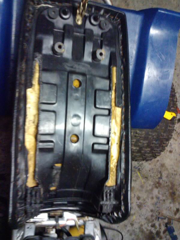

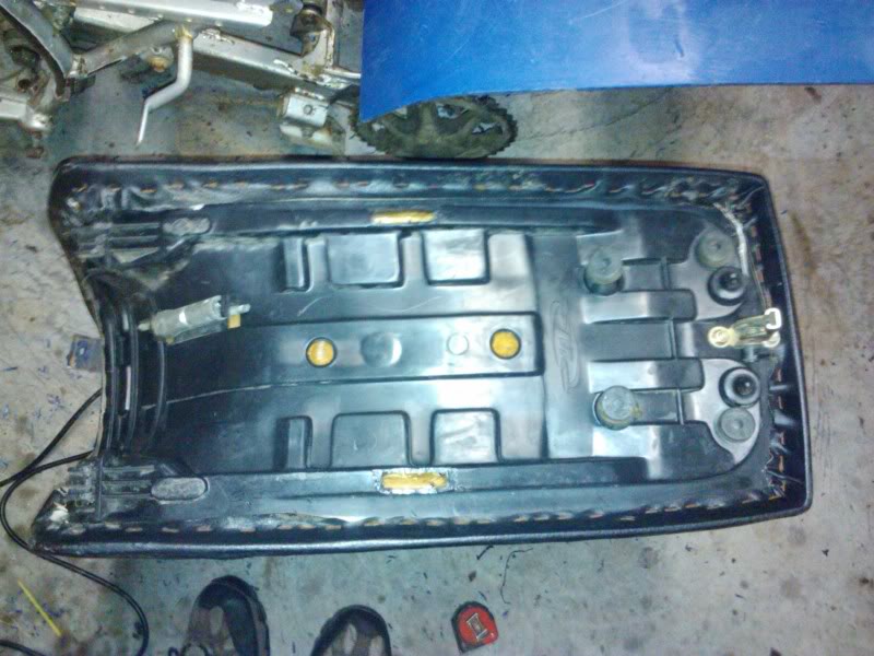

5 - I am using a Kasea seat on my bike ( it was the only good one I had ) and needed to trim the bottom of the seat so it would lay flat on the plastics, the place where it use to sit has a 'dip' in the plastics but is now a few inches back. Without this the front of the seat sat too high and may a big gap between the seat and plastics 'body line', your seat MAY be different, always check twice before cutting!

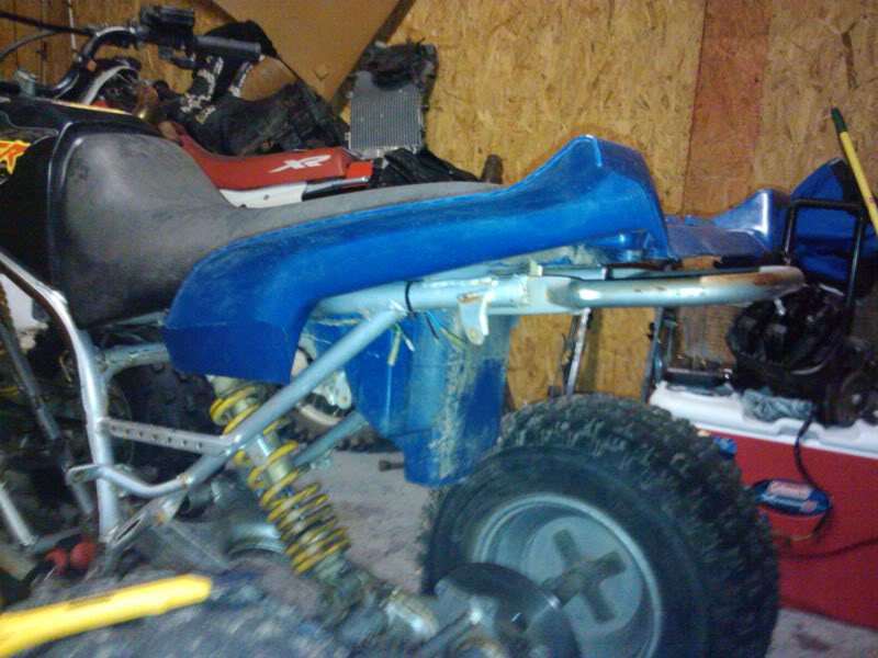

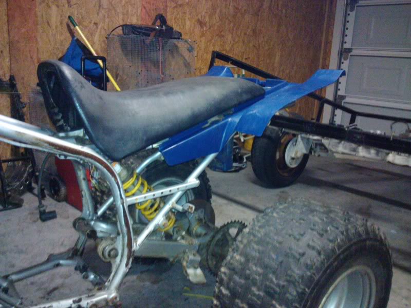

6 - Slide it all back together, at this point you notice that you can move the plastics to the desired length, I put mine back 5 inches in the pics.
7 - Once you locate the desired spot you may need to notch where the bottom back of the seat meets the plastics, I notced mine a little too deep in the pics, but I'll give it a fix later.
8 - Once the notch's have been made, put the seat back on and make sure you like where it is.
9 - Now that everything is cut and in place you can secure it to the frame. I do not like the idea of just drilling a hole in the frame or self tapping screws, so I plan on picking up a stretch of angle iron and tacking it up to the frame and mounting it this way, or some 2 sided tape may do you well - I haven't decided how I will mount mine quite yet and it will depend on your ability/skill. 10 - Once mounted feel free to find some mud if you did it for better protection or some good turns and notice all the extra room you have to move around the bike!

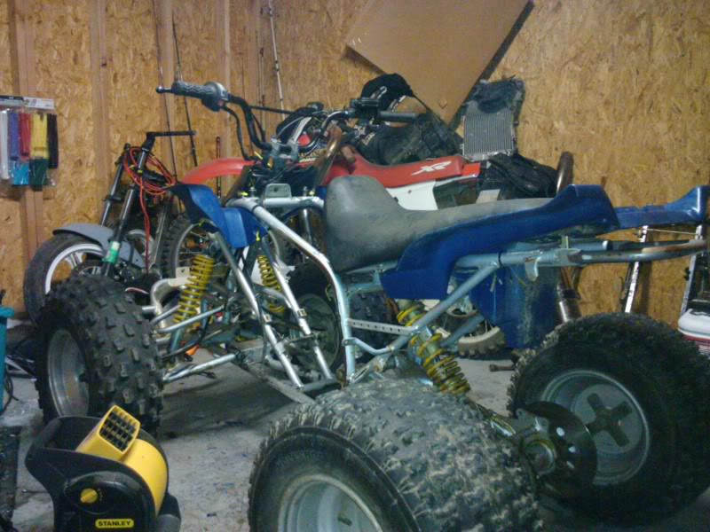

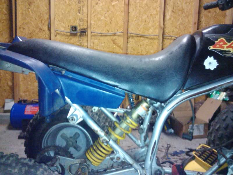

That kinda make me laugh, while waiting on parts to arive I decided to try this out on some spare plastics, kinda like the look. I did some more trimming today on the under side of the seat to bring the side lower on the plastics. I dont think it looks that bad but is NOT worth all the work!

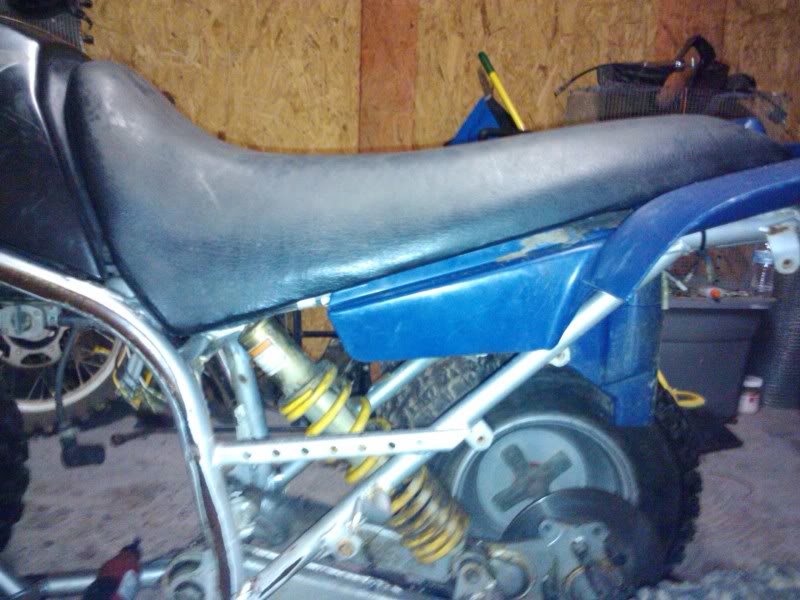

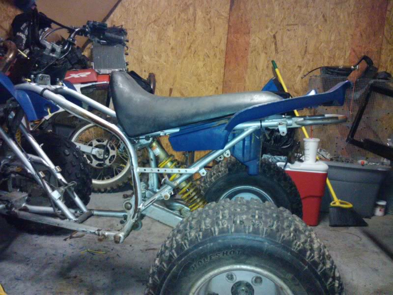

Here is a short update......I'm nowhere close to done, but I did it differently since I wanted to retain my tool box. I'm about 1.5" back now. Might go a tid bit more back, but not much(if at all). The first pics are the stock ones and the 2nd is 1.5" back.
