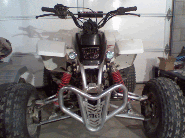

diamond J ---- installed it!!
i had a buddy come help me install my kit last night.
it took about three hours to install and be satisfied. the instructions were vague, at best. i had to look at the sticker that shipped with it to know how to put the top shock mount on, ha.
it mounted pretty easy and feels very secure. the fact that i can use different shocks now makes me salivate a bit..
so, i rode around for a bit.. popped some wheelies... did some small jumps and got off and checked all the bolts and fittings... they were all tight. ( i will disassemble it soon and use thread-locker). i then went to the big jump and it felt very good. it absolutely makes the shocks softer. i actually bottomed the front shocks out once.
as far as cornering, it obviously looses some of it's tight turning radius, but thanks to the extra six inches in the front ( and my +4 rear ) i can now easily just power into a turn and let the rear end slide around without fear of tipping.
i can now ride in the ruts cut by the larger quads and corner with more authority.
it adds some weight, but not noticeably when riding or riding wheelies.
