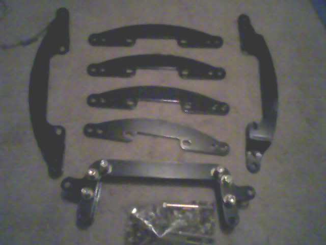

*Here is the kit, i cant remember how much it weighs

The diamond J kit is very affordable, very functional, super strong(If I have not broken it yet it can't break) and very easy and straight forward to install. I actually like the look of it cause it pushes the shocks out more and looks alot beefier than the std skinny blaster front center. Plus, it utilizes all the stock suspension components and still leaves room to upgrade later if you choose to do so. It is a win win situation, a no brainer.
